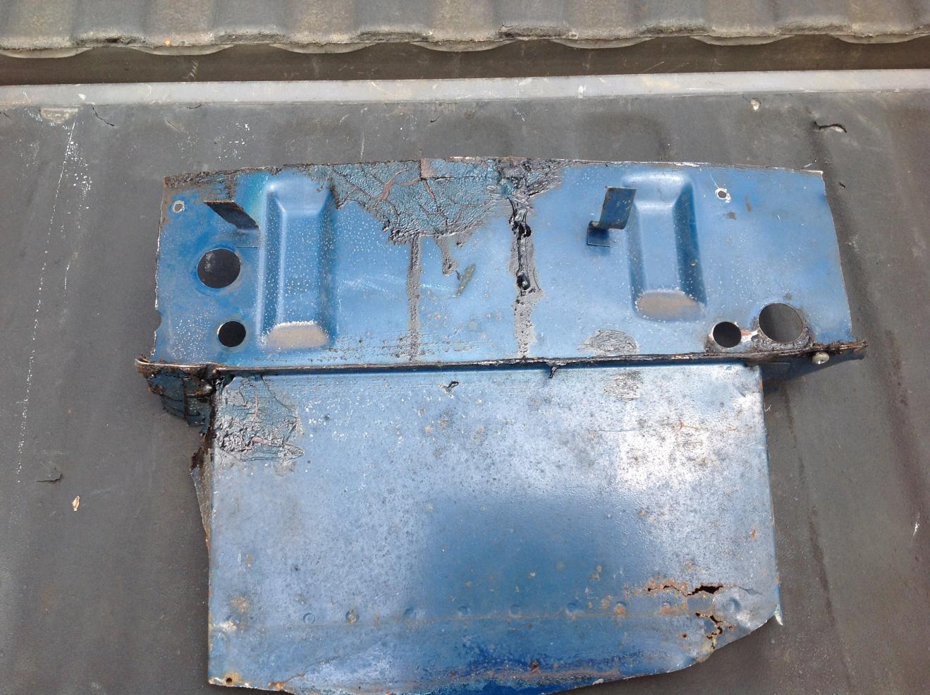

Ron,
I found a picture of my rusted out 73 parts car and wanted to check and see if this is the part you need. I hope to be down at the farm within the next week and can cut this one out if you shoot me the dimensions.
Rut

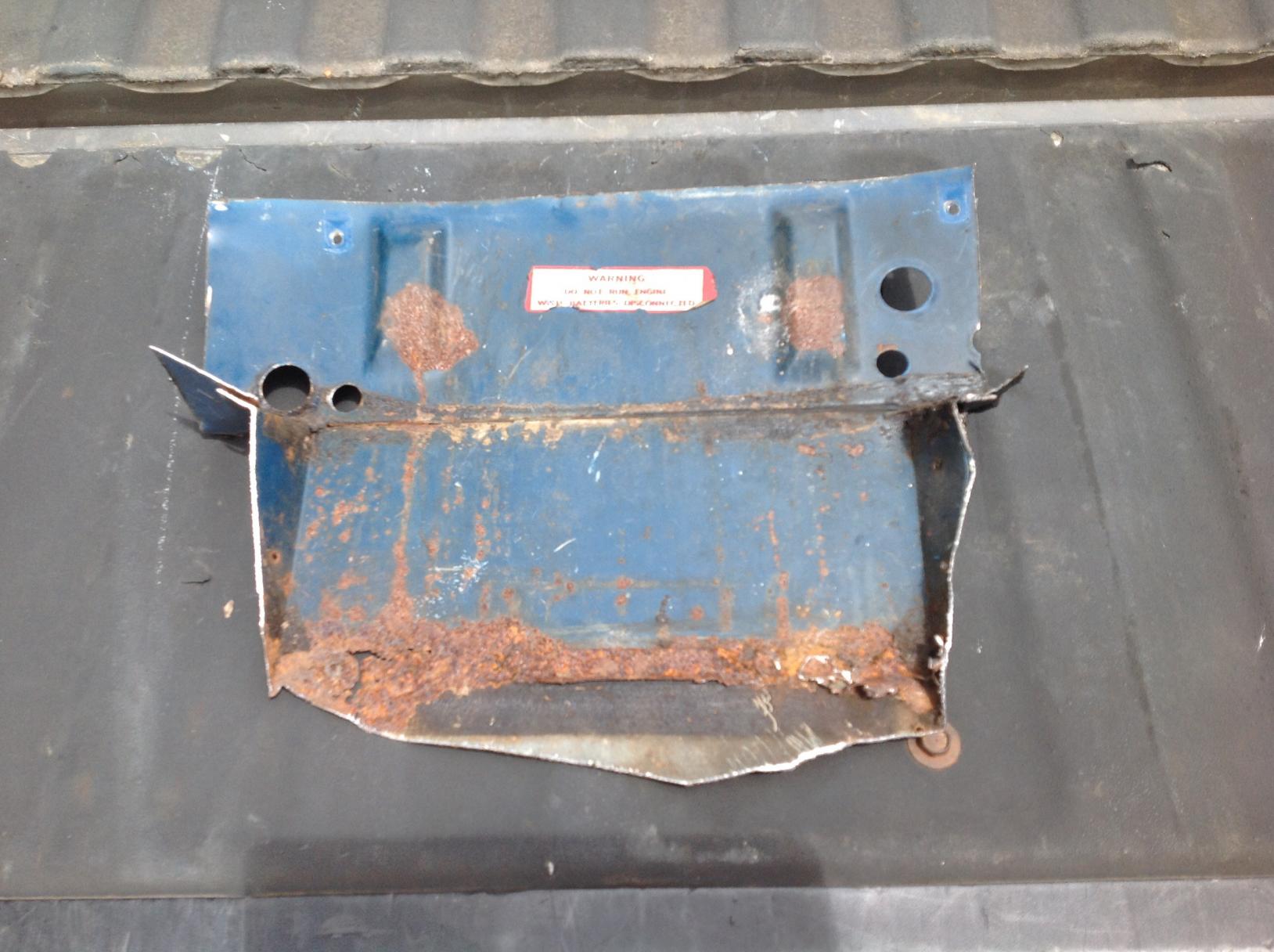

Rut, that's what I need! I need the section with the ribs, which works out to 5" x 11". I'll shoot you a PM. Thanks again!

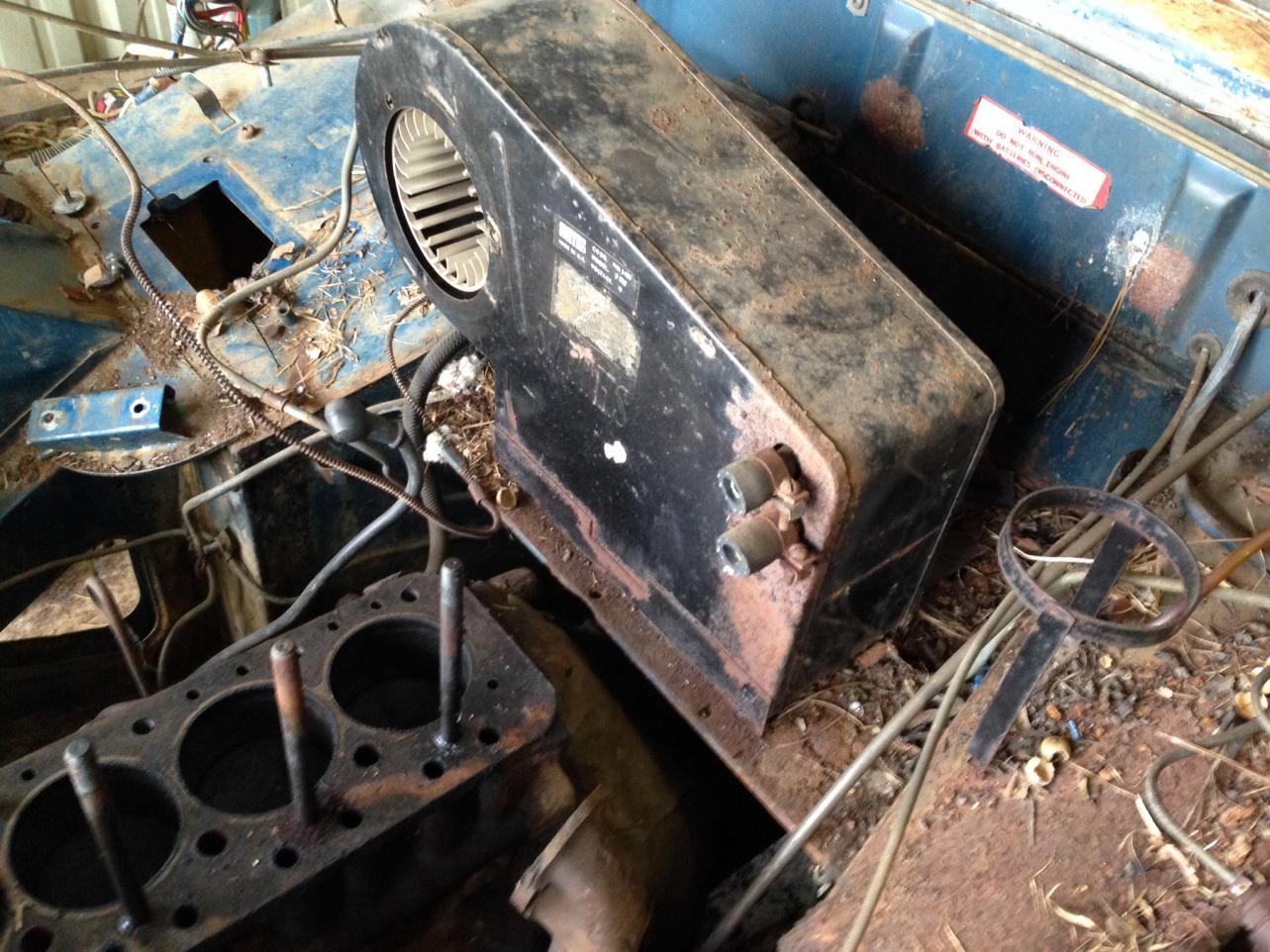

Ron,
was able to make it to the farm today and pulled a few pieces I needed along with the firewall. I didn't know how far down you rust goes so I went amost to the transmission tunnel.

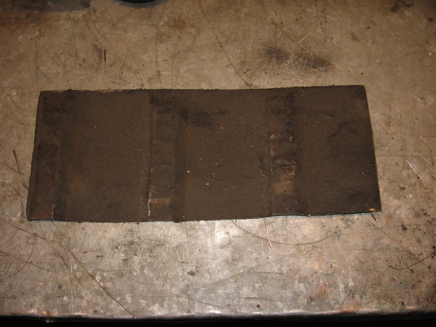

I've also seen someone fabricate one from scraps of floorpan that had have the same basic shape.
i did that on mine. It worked out great! My album, which documents the work, is on spritespot page two of the photo album section titled "1960 Bugeye refurb". Sorry I can't figure out how to do a hyper link on this I PAD for you.

here's three of the photos from my album. After butt welding them in place and carefully grinding down the welds with a dremal tool, the repairs only needed a small amount of filler to complete the job. I'll get back to adding more pictures to that album when I finish the paint this summer.
hope this helps.
