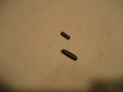

OK, I pulled the plugs and noticed that #4 looked like it had some scratches on it....So I put a magnetic probe down the hole and pulled out the steel shards shown in the photo.
I assume that these are pieces of valve? Thanks

Hard to say what those are, but valve wouldn't be my first guess. Doesn't really matter, though, it's time to pull the head and get the rest of the bad news.
bnw
Looks like you might have sucked something down the intake. Can't tell the size of what you've got. Was the spark plug intact?

Yes the spark plug is intact and actually just looked barely scratched - I almost missed it.
But I only drove for a couple of blocks. For once I had the wisdom to not try to drive the 5 miles home.
So if it is a piston, how much more difficult is that to repair than just the valve? I will probably have the car towed to my shop but I want to be prepared before I get the sticker shock.
