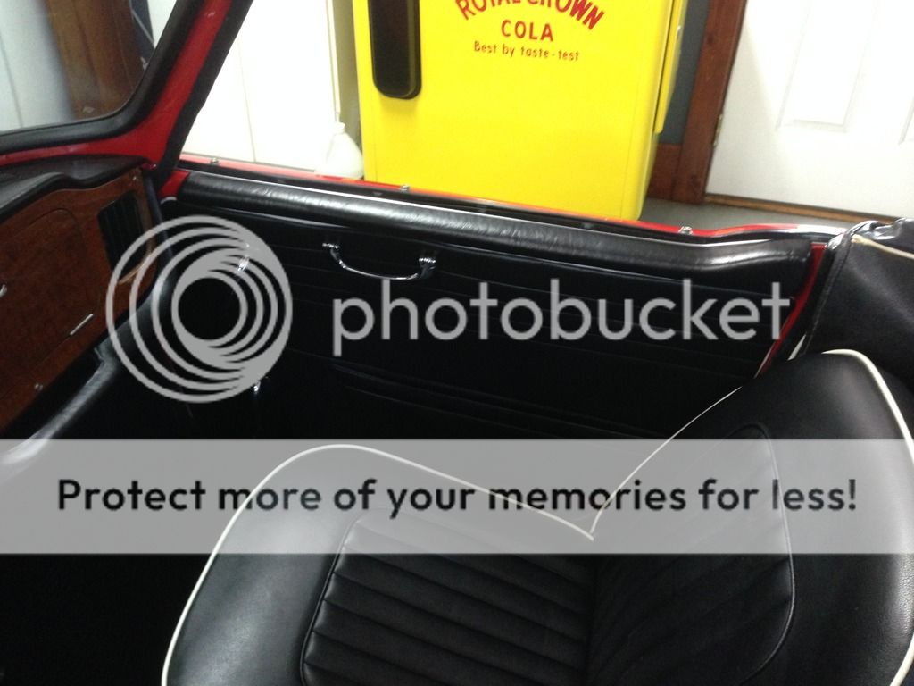

Good morning...I think I know the answer, but did the 67 TR4a have door capping? Reading Original Triumph does not state if it did or not, just refers to 4 and then 250/5, but the 4a still had pull handles, so I'm assuming no caps?
Thanks, Rut
Foura
Yes Rut. The 4A had door cappings. I installed new ones when I rebuilt mine. Later, when I had it professionally retrimmed, they left the caps off. I liked the extra width and they are a PITA to install so I left them off. I might be short but I have broad shoulders....

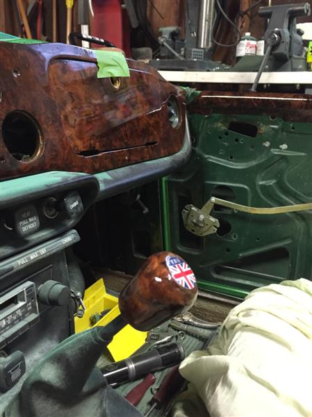

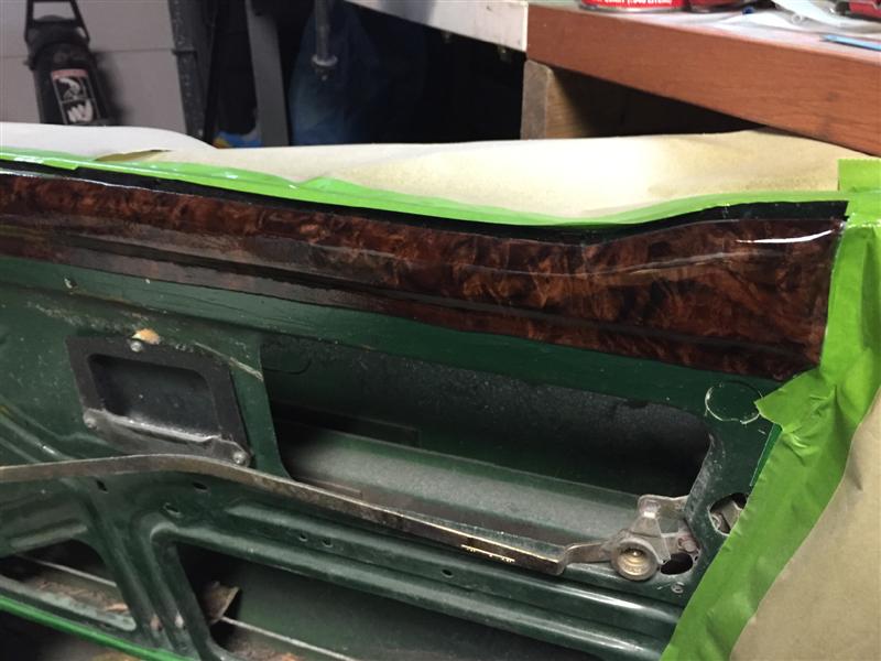

Rut, you could do something like this on your resto mod.

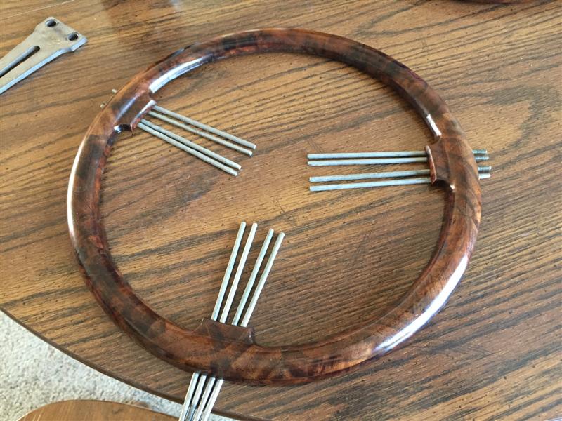

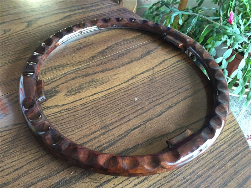

tomshobby
This is part of that project. A completely custom steering wheel. All the wood was carefully chosen to match the dash, shift knob, and door caps. I won't finish this until this winter. The metal work; which is all p17 stainless chosen for it's strength and toughness.
