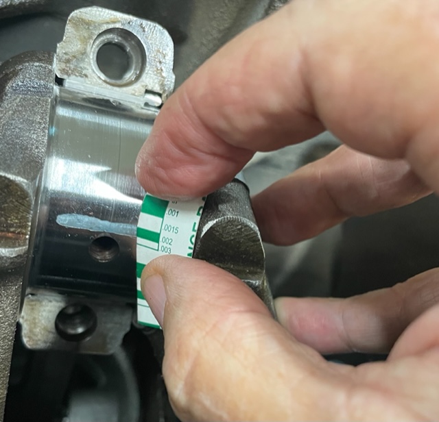

Maybe some folks here will have an opinion about connecting rod bearing clearances. Please see attached pic.
I'm using .010 undersized bearings, and my journals measure right on the mark at about 2.076 (stock is 2.086). Sounds near perfect, but my PlastiGauge shows barely .0020 clearance and I'm supposed to be at least .0028 according to the Shop Manual. I say I should torque things up and go for a nice ride.
Any thought this is just too tight? I thought so at first, but then wondered whether a variance of .0008 could really mean that much--assuming PlastiGauge is all that accurate.
Thoughts?
PS I'm ignoring that wide smear to the left since a re-torque did in fact eliminate that aberration. The right half is accurate.
