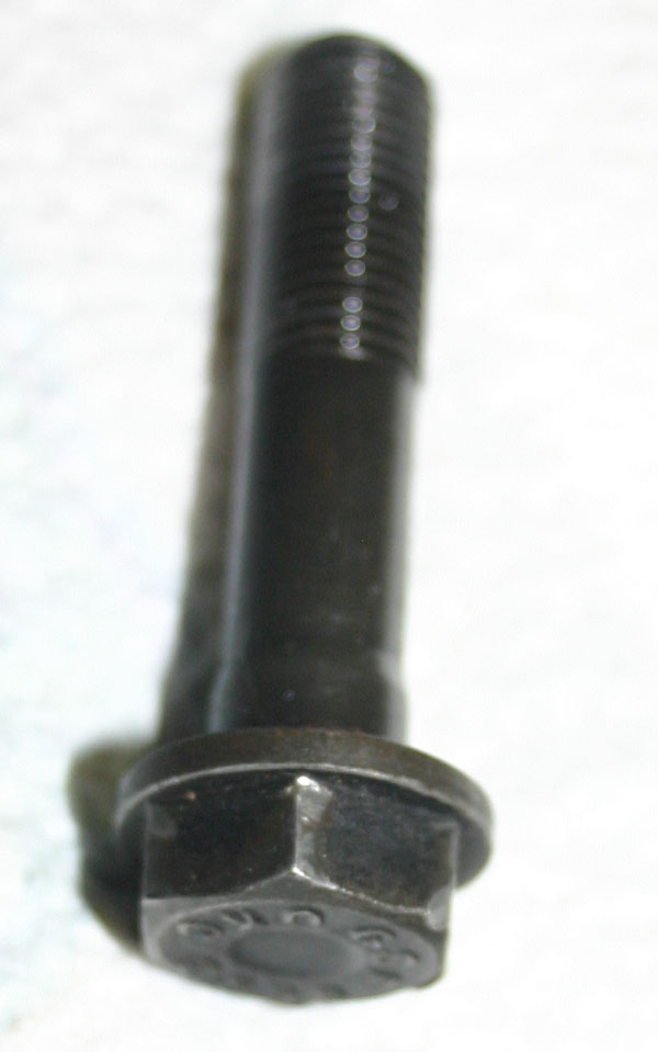

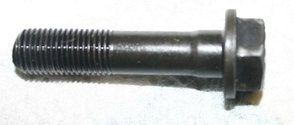

The book has two different torque figures for these depending on whether they are color-dyed or phosphate. I am going to post a picture of my bolts in hopes that someone can definitively tell me which I have.
Ok, here are a couple of pics of one of the rod bolts. Can some one tell me if these are "color dyed" or "phosphate?" They are out of a stock 1979 Spitfire 1500 motor, if that helps. The book gives two different torque amounts depending on which type bolt it is, but no info on how to tell which is which.

Basil hello;..Those standard factory bolts were the highest standard OEM
bolts for the time & black oxide coated.
I recommend you replace all those bolts with GRADE 8740 CHROME ALLOY MOLY BOLTS.
If they are original they are old & not trustworthy.
The bolt size you need is;3/8x1.65UNF AT 47FT# TORQUE
Good Luck
Ken&Whitelightning
To answer the original question, those look like black phosphate (aka parkerized) to me.
"Color dyed" typically means zinc, cadmium or dichromium plating. How different is the torque spec? I'd guess about 55 lb/ft?. Does the spec call for oiled or dry threads?
Those are well engineered bolts, the shoulders are raised and radiused, and there's an integral washer under the head and the caps are dimpled. Can't tell if the threads are cut or rolled though. The real question is how many times they have been torqued.
