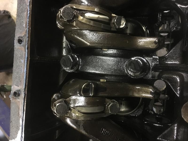

I'm disassembling a TR3a engine for overhaul and discovered the locking tab washers appear to be deformed. Being new to Triumph engines, I wanted to make sure of what I am looking at. Also, would someone please direct me to a good engine disassembly, reassembly thread? The red book leaves a little to be desired for detail sometimes.

Regarding the locking tabs. My bet would be for the previous person to have caused that deformation when the bolts were tightened down.
From the direction they are deformed it's as if the rod bolts were actually loosening. All of the rods exhibit this.
Maybe the tabs were re-used? Ends bent down to remove the bolts, then tapped back up after bolts were torqued, but bolt heads ended up in slightly different rotation.
You should always build with new locking tabs, and they are cheap. It appears your PO re-used the tabs.

I've recently been trying to educate myself about bolts, how they loosen, and how to keep them tight. One result is that lock tabs really are not a good way to keep bolts tight, and you may be seeing an example of that. You can replace those bolts with the more modern TR4 stretch bolts, which I'd recommend. The following article is a little whimsical, but I think basically correct:

Thank you all for your input. I think I will order a set of TR4 rod bolts. Am I reading the Moss catalog correctly that part number 320-450 is $16.99. Is that a piece?
Yup. Check the "Where Used" tab, it says you need 8 of them.
