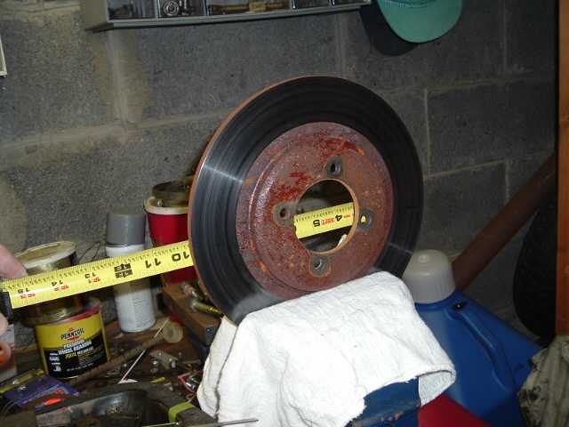

I am hoping someone on this forum may know what British car has this size brake rotor.(see sizes below). Our RF 80 Van Diemen formula ford is said to use a stock british car brake rotor, possibly a Trimuph GT6.The main issue is the height of the “hat” which is much shorter at only ½ inch. Any help in resolving this issue would be greatly appreciated.
Current rotor dimension are
Hat height = .50”
Hat I.D. = 2.62”
Hat dia 5.45”
Worn rotor thickness .31”
Disc dia = 9.75”
Bolt circle = 4 X 3.75
Stud hole = 3/8”
I attach pictures of the rotor.

Not only the hat dimensions but the rotor diameter are different in a Spit and the GT6 rotors.
You might slide over to the Apex Speed forum in the FF/CF section and see if there is any thing else that might be close but I really doubt it.
tr8todd
Could be a tr7 or tr8. I'll measure them up when I get home and let you know. The only other car that uses a 4 X 3.75 is a Lotus.

The hat dim is much to short for a TR8 (I've got new TR8 rotors on my bench right now, hat dim from rotor surface is like 1 5/8")
tr8todd
With such a short distance between the hat face and the rotor face, how can you get a caliper in there without it hitting the wheel? A rotor like that must have come off of a car with inboard discs. My guess would be Jaguar or possibly a TVR 280i.

Thanks for the info. The same request is on Apex Speed. So far it looks like a custom hat rotor combo. The current rotor is a one piece and had to come from some car. I will keep searching. Will post if I ever find the part.

I can't be certain ("old-timers' disease") but I *think* I remember Jag rears as having no "hat"... and if TVR used them, I doubt it would be exclusive to that particular marque. Can't find my E-type manual ATM.
I'll be curious to find out what it is from.

Some Swifts also use the same rotor.
this whole flog was laid out in the old FF Underground board...thats how long ago.....
Even IF.......they came off a car (which they didn't)knowing the Brit kit car guys they would use some obsolete /low volume rotor and the cost still would be $70 each due to the low usage/volume...which is about what they cost in the UK. /ubbthreads/images/graemlins/england.gif
