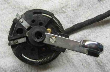

I've had my trafficator out many times. You can remove it right at the steering wheel, without having to pull the complete wire harness up through the stator tube. It takes about 10 minutes. There is no adjustment in the trafficator. It either makes contact or it doesn't. If it's staying in the locked position, then it should be making contact. A brass clip will slide over the brass bolt head. The brass head my have worn down, but you should have had some sort of heads up with that, works, doesn't work sometimes.

Roger, it only ticks when right side is turned. Won't stay on the left side and doesn't tick. I think the alignment shifted and there is no contact with the points to the left. I've had the trafficator out half a dozen times in the past 10 years just not in the past 5 or 6. Its no sweet. I'm just looking for a connection between it and the brakes. I will be checking the brake switch continuity. May be a ground problem. But they do light with the head lamps as they are suppose to.

Rich, if the tab will not stay in position when pushed to the left, then the problem may be in the trafficator. The V-section that the roller clicks in and out of, may have the edges worn, thereby not letting it click into position. You can build it back up with JB weld, then sand into shape or send it out for repair by having that plate replaced.
