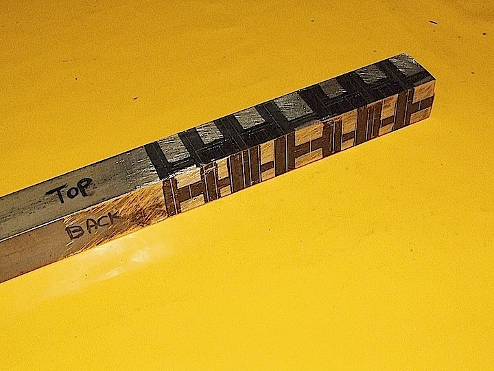

Seriously, good to see the innards of the original Delco switch. I wonder... if the failure is the wear on that brass head, could it be turned 90° to present a fresh surface to the contacts?
Oh, on second look I think I get it -- you made the replacement button longer to make up for the contacts being shorter after the worn ends were removed/broken off.
