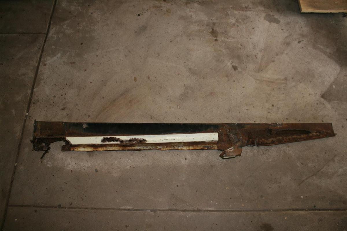

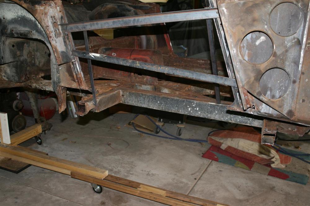

I thought I'd share a couple of pics of progress on the BN4; one of those days when I feel quite chuffed at what I've achieved. :glee: I finished removing the r/h side sill. (sounds easy if you say it quickly). I've done this before on an MGA, but this was a new kettle of fish!!! Very tricky! I braced the door openings and nothing seems to have moved. The wooden rotisserie also seems ok (touch wood). I've also cut rust from the bottom of the A and B posts and removed the floors. The chassis and outriggers look good, a couple of dents here and there but nothing serious. i'll order new panels from Kilmartin and take the job one side at a time. If any one has any hints or tips that would be appreciated.
On another note, I really like the Healey blue colour, but I'm a bit concerned about spraying metalics. I'll be using acrylic lacquer. I'm not an expert, but I have sprayed six cars over the years. What do you think? sill removal (2).jpgsill removal (4).jpgthe offending sill.jpg

Thanks for sharing the pictures. The braces look fine.
In spraying the Healey blue yourself, I would go for a test on a scap panel.

Bad rockers but good outriggers? Thats unusual for a 100. Bracing looks good but I like to mount door and make sure the door fit is where I want it before the finish weld of the sill.

I agree with everyone about testing the door fit, and test it often. Which is why when I put the body braces I made sure they did not interfere with the door closing. You may have to move one or both of your braces to fit the door. Heres a little color teaser for motivation.

Thanks for the replies and encouragements everyone. Healeyblue, your car looks beautiful. I will have to move the bracing to mount the doors. Do you think their is a danger of loosing the original gap if I loosen them without the sills in place?

Oxford, I put my braces just inside of the door closer points. One angle iron was welded to the pad where the convertible top is bolted to the body and the other end is welded inside and up against the front weather strip knife edge. Put these in before you remove your existing ones.

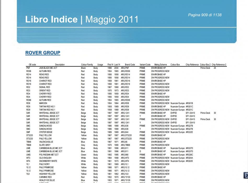

Yes do as Vette says and put the new braces on before removing the existing ones. However if it does move now with all that metal removed you should be able to push the gaps back and reweld the braces. As far as the paint code I am sure my painter just entered in the BU2 code and was able to get a cross reference to what ever paint line he was going to use. I have used automotivetouchup.com before for BU2 and they also were also able to mix the color correct just by using BU2. I had them put it in spray cans.
