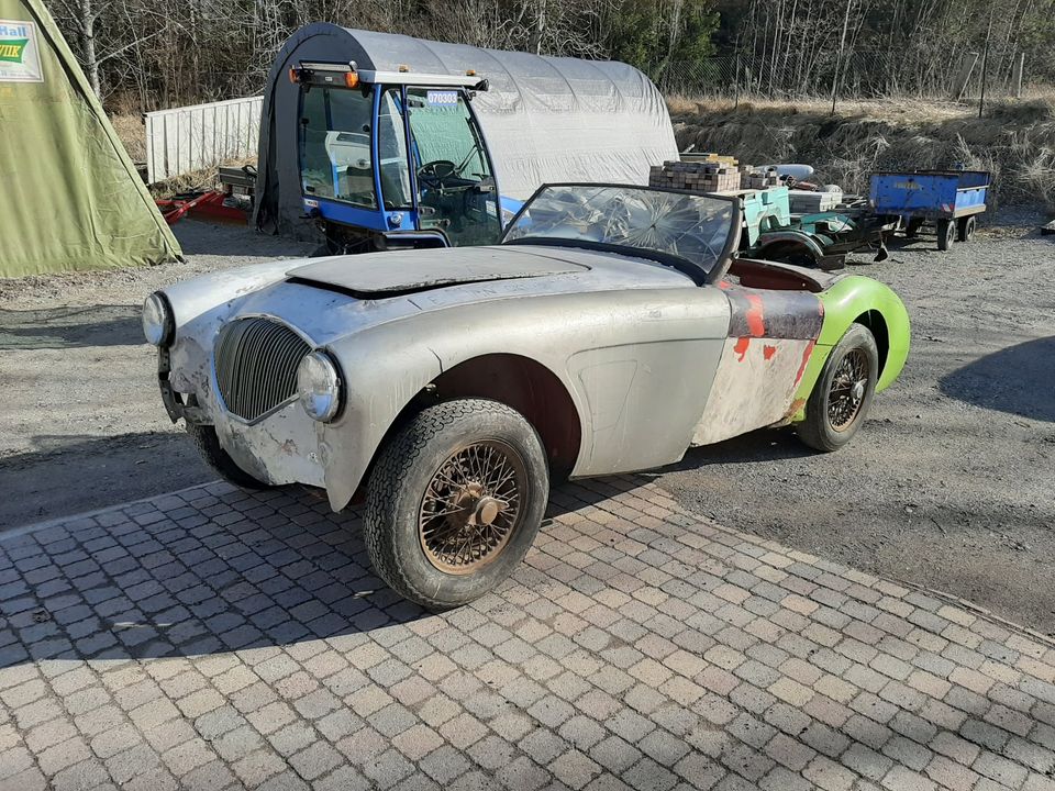

CraigC
Just saw these pics show up on Facebook this evening. Car is for sale in Norway.
