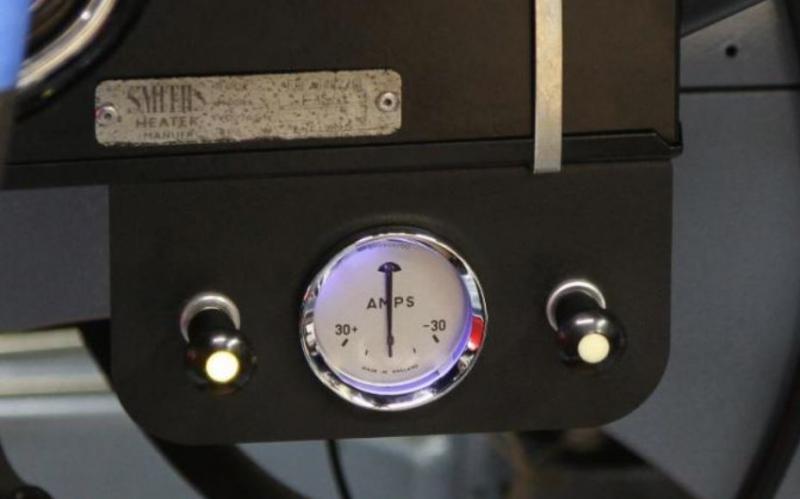

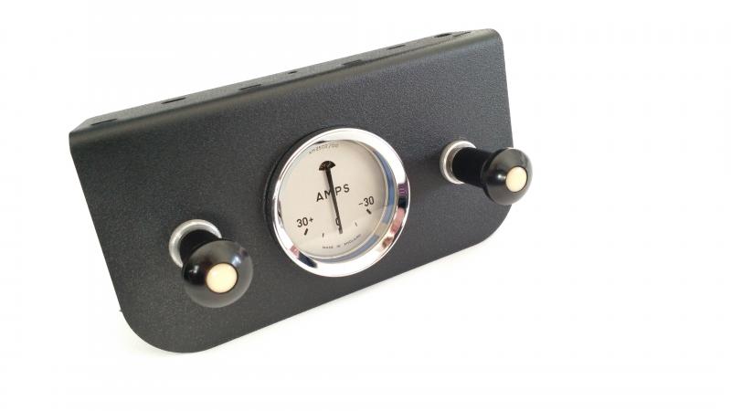

Also, on the last picture what is the item on the far right with the fat black wires? Is it one large fuse on the main power coming from the solenoid? If so, why?
I installed an original Smiths ammeter and the fuse is to protect the the ammeter system from any unauthorized shorting of the ammeter wires to the chassis. (See images below.)
