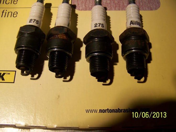

Jim Lee
This is not such a great picture but it shows the plugs 1 through 4 from left to right. #1 looks good to me and then they get
rich looking to my eyes.
TR3driver
Great Pumpkin - R.I.P
Whatever you've got in the dashpots is way too thin. Or else not enough or there is something broken in there. There should be a pause between when you open the throttle and when the piston rises, as it takes time for the air pressure to overcome the resistance of the dashpot plungers moving through the oil.

One of many things that confuses me is that my plugs look rich, like they are getting too much fuel, while I believe that backfiring out of a carb
signals a lean condition.
The mixture is by no means constant, so yes, this is quite possible. In particular, it is possible for the needles and/or jets to wear (from improper centering or a worn out dome/piston assembly) such that the idle mixture is way rich compared to the cruise mixture. Then since the mixture is normally adjusted at idle, the cruise mixture winds up way lean. In more severe cases, the mixture nut may not have enough range to lean out the idle mixture enough! (My buddy had that problem with his MGA.) Or, the lean cruise mixture may cause persistent overheating (which I now believe is what caused my Dad's TR3A to overheat and eventually swallow a valve).

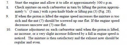

Also, what is "the lift the air valve method of determining the correct mixture"?
This is the method given in the manuals for setting the mixture (hopefully you can read this image after clicking on it).
