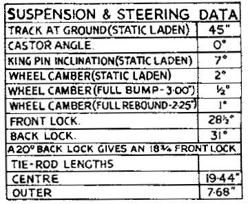

One way to tell is to take it to an alignment shop and have them measure both camber and king pin inclination (aka steering axis inclination). If the KPI is right but the camber is wrong, then you've got a problem with the vertical link or spindle or possibly the upper ball joint. But if the KPI is off as well, then the problem has to be with the pivots or arms (or one of the joints).
