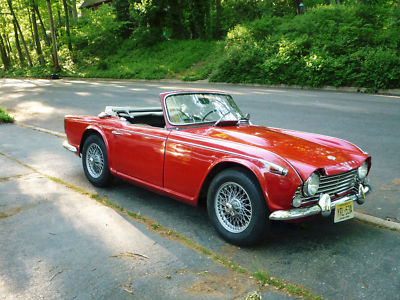

Here are a few pics If I can upload them. The car has very little rust and from 10' looks pretty good. The hood however has some paint issues. The finish is cracking on vintage guitars they call it checking. OK on old Guitars not so cool on my TR. Something to add to the list. Mechanically the car is pretty sound.

Nice looking car!
Speaking as a fellow live axle owner, you'll be fine with the stock setup. Rebuilt/serviced levers and properly lubricated leaf springs work pretty well for me. Get the car sorted out and then you can start thinking about the upgrades in other areas.
