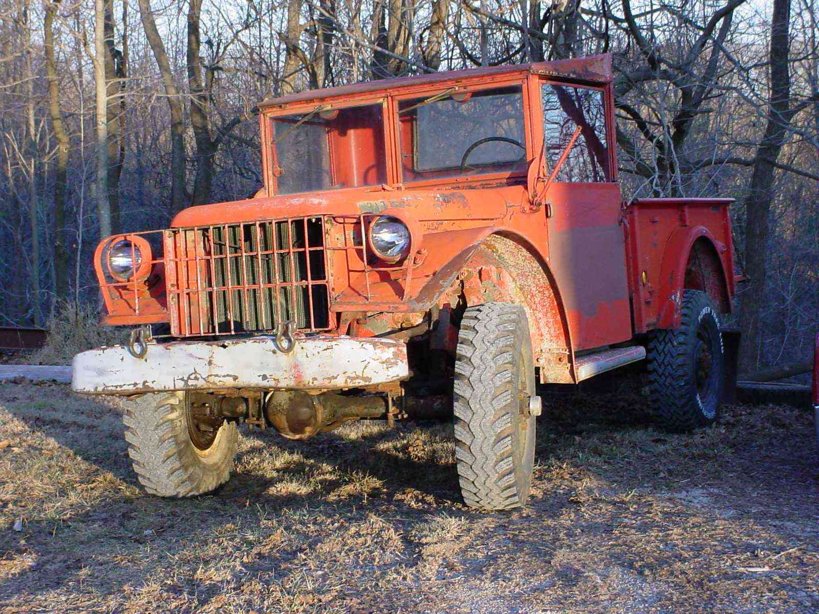

That is a '58 M-37 that I bought from a junk yard about 8 years ago. It only had 10,000 miles on it but I had to rebuild the engine because of the mice in the cylinders. I use it on the farm and I just installed a snow plow in an attempt to change the weather.
