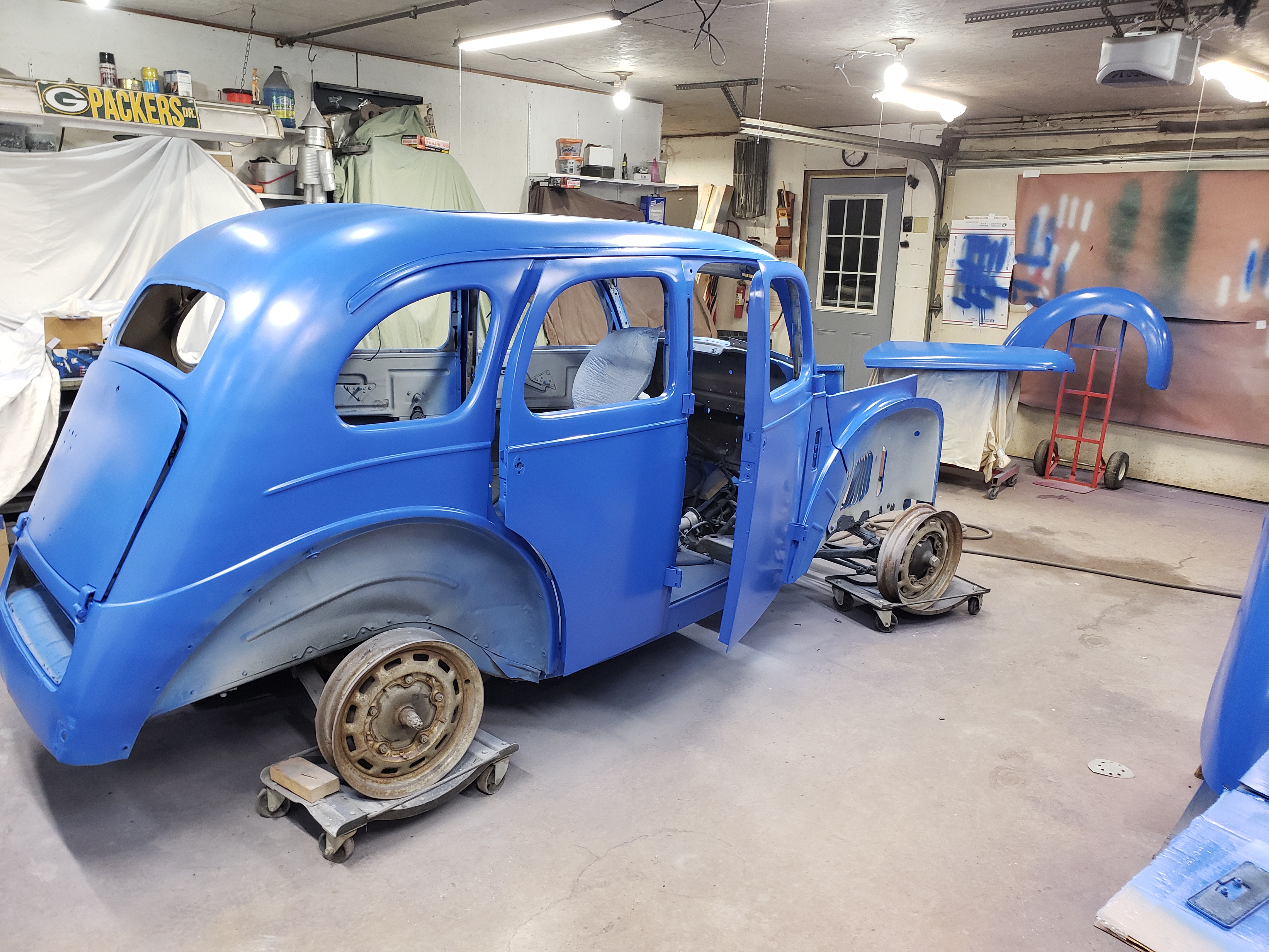

My Prefect has a spare-tire door below the boot and for what ever reason there are no hinges just two tabs that hold it too the bottom and a latch on top but one good bump and the tire door will fall of which must be the reason it was all beat up.
First, I gotta say it is really looking great at this point. Maybe I can get mine painted by this fall, I hope.
Pretty much every fastener has been off my '48 Prefect and I have never found anything metric. And can you be more specific about the gap between doors and body, photo maybe? I can't add much on the spare tire door except to say the British builds were like that and I have not seen any other complaints about it. Maybe the tabs are bent or distorted. Mine seems to be unique in that it has an extended boot like the Aussie builds although it is English build. Best guess is that it was an experiment to see if more luggage space might help North American sales.
