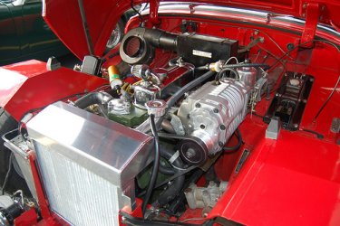

So much info here that I can only agree to. My BE has a Moss SC unit with a motor built by Kent Prather out of Topeka KS. for street use and pump gas. It is the best of both worlds. Since I put it in 3 yrs ago I've put over 10,000 miles on it, including a trip to Elkhart Lakes, Wisc about a month ago. The SC does give a nice blend of low rpm power and not run out of power at higher rpms. The lightened flywheel again is a great compromise for a street engine. I've thought of a 3.7 rear diff, but am really happy with a 3.9 and just haven't tried one out. 80 mph is a tic above 4000 rpm. On my trip I ran at 75, seemed a happy compromise. Miles and smiles.
bill_young
There are a couple of guys from the Topeka area with almost identical supercharged Bugeyes. Here's one at the Spridget 50 last year. Engines were built up by Kent Prather, but I'm sure that Hap can fill you in on a good compression and cam combination. I don't think either of them has the 3.7 rear gear though, works just fine with a 3.9 and the 5 speed. As far as suspension upgrades, those are pretty basic unless you want to get into a lot of custom fabrication. Just install good uprated pads on the front discs, something like EBC green or yellow, poly bushings, and a good anti roll bar and you'll be fine. I wouldn't recommend a rear bar for the supercharged car, perhaps for the V8 depending on final weight up front. Some modified Spridgets on the British V8 Newsletter photo area and a couple of V8s under construction being discussed off and on in their forum. https://www.britishv8.org/British-HotRod-Photo-Gallery.htm or https://forum.britishv8.org/read.php?4,5291
