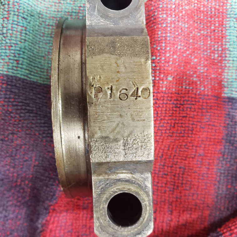

I'm rebuilding a 1275 (pre A+) engine and wondering if we have many classic Mini owners here. Have one specific question. "P1640" is stamped on the three main bearing caps and on the front face of the block (upper left corner, ALF). Mean anything to anybody?

The man I asked (who is an experienced engine-builder) confirmed what I thought after seeing the photograph: that main-bearing cap looks like steel rather than cast-iron.
In which case the code will indicate some aspect of how the block and caps were line-bored as a set prior to assembly (and the significance of the characters will depend on the machinist / machine-shop).
Do you know the provenance of this engine? Was it built for competition?
