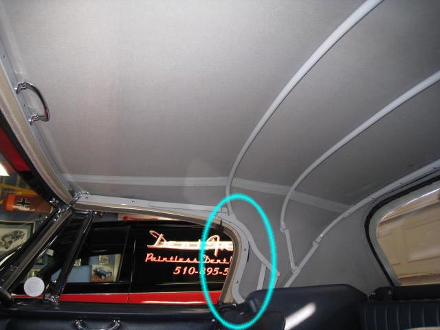

Bob,
Beautiful car!
From the photos the window appears to be as high as it should go. It's level with the top of the vent window frame.
Seems the sides of the top are not low enough. The window glass should be pressing against the side of the rubber trim, not touching the bottom of it.
I think the metal frame and the wood side pieces may need adjusting to let the top sit a little lower. Once that is done, then the top cover may need to be refit.

I agree with Roger that the wood side pieces are worth a look at. If you look at the picture Roger posted, you'll see that the wood is not flush with the leading edge of the metal frame, but set forward and below it.

Bob, I just took these photos.
Notice the difference between the drivers frame alignment and the passenger side.
Photos:
1. Drivers side frame.
2. Passenger side frame.
3. Passenger side wood.
4. Passenger top of glass to top gap size
5. Passenger glass rear curve
