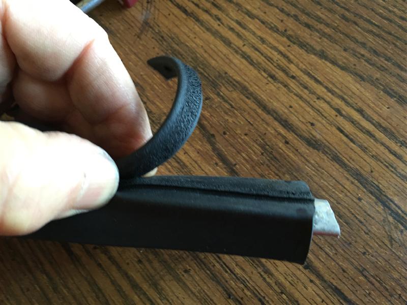

The first thing is to remove the aluminum channel then cut the gasket to length. With that done slip the gasket into the channel. That is done to use the channel for a guide to make holes in the gasket to have a place to insert the screws and the Phillips screw driver.

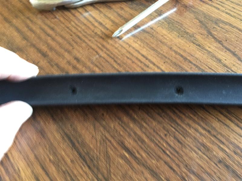

With the gasket in the channel I had the guide for placing the hole locations. A 1/8" drill worked to make the holes. Next I removed the gasket and used a scissors to cut away the part of the gasket that was supposed to fit in the channel.

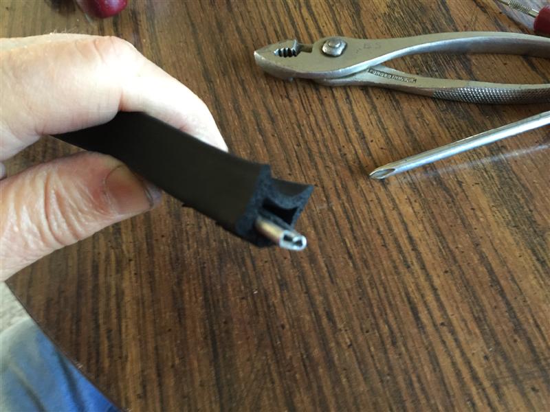

Then I inserted the channel inside the gasket.

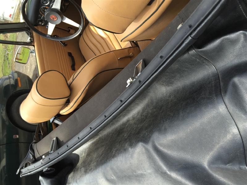

I found the original screws too short to get purchase in the top frame. Instead I used #8 x 3/4" Phillips pan head screws. They worked great.

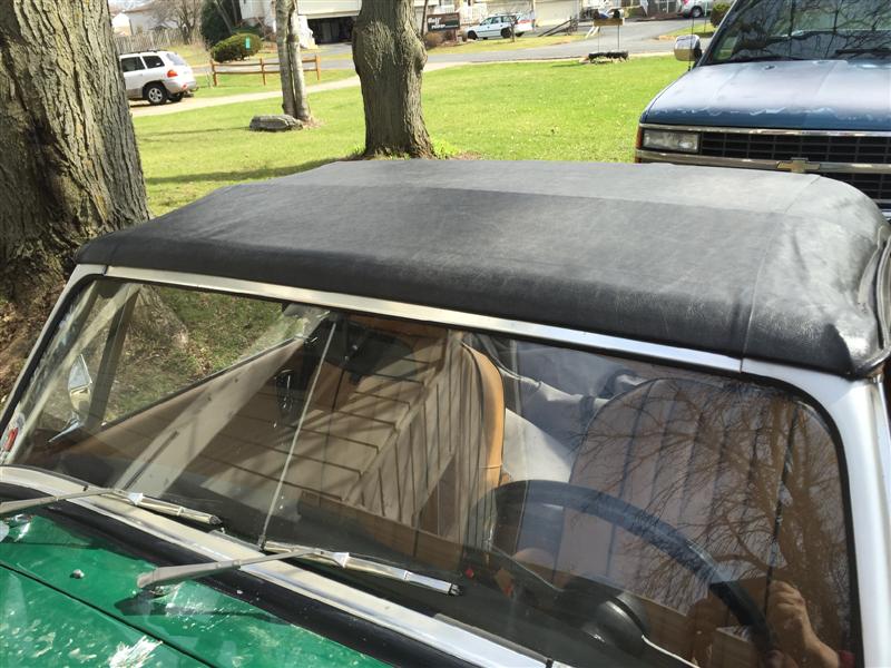

Last evening Shirley and I had a very difficult time latching the top with the gasket in the channel. Today I did not have much trouble latching it with this new approach.
Another huge benefit is that the gasket is extremely well attached. Also the gasket now not only seals the windscreen side but also seals the side against the top frame.
