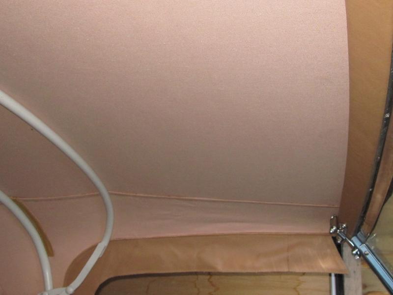

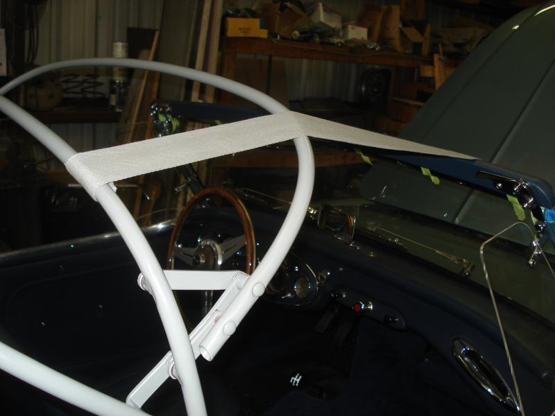

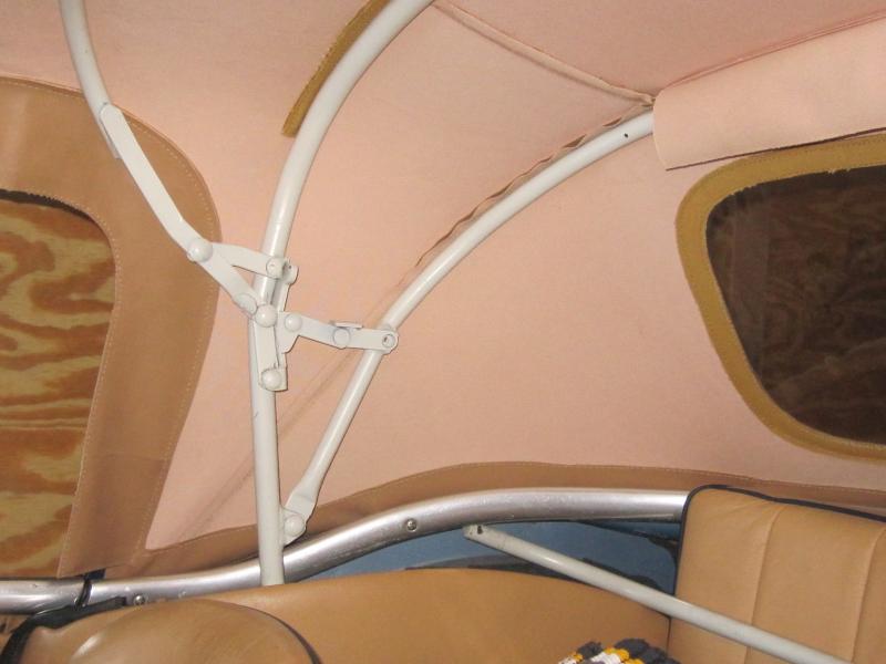

I went out and looked at the top on my BT7. This top was installed a few years ago, before we bought the car. There is a piece of cloth above the rear window, but it is evenly draped over the last bow above the window and does not appear to be fastened to the bow. Maybe it should be fastened, but it has never been an issue as is.
blueskies
Here are a few pics. Not sure whether it is done right or not, but it works well.
