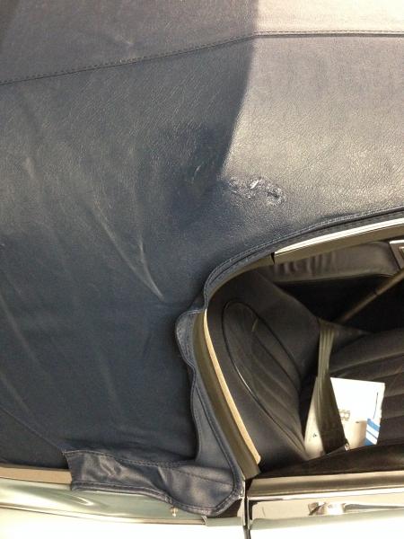

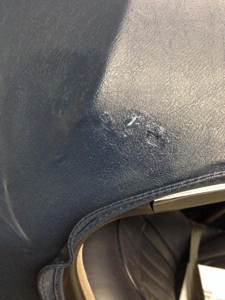

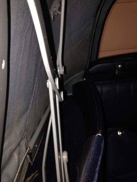

Thanks for the tips guys. I really do try and push the top material away from the frame as I fold it. This has happened since day one, so something is wrong. It is fine until the last inch or so, and then it just wants to slice. I've attached some pics in case they might help.

This is a condition that is very common to Convertibles and, as others suggest, makes folding the top a slow and careful process. Although your issue seems higher on the side then is usual, the cause is often inflicted lower on the side and is caused by the scissor effect of the frame's closing.
I caused the first cut in my top on the day I picked up the new Healey and put the top down. I installed a new top in around 1972 (still in great condition) and, although I now was aware of this issue and being very careful, still put small cuts into the replacement. As you have described, the last few inches are the closing is when you must be extremely carful and, moving from side to side, put your hand down each side to make sure the top hasn't moved into the path of the closing frame (which is its natural folding tendency).
Good luck and keep being careful and don't push the top down hard,
Ray(64BJ8P1)
Correct. Move back and forth on each side making sure the top material does not get pinched in the frame as you fold it down. Pull the corners away as you close the top. It usually takes me 2 or 3 times back and forth to make sure it doesn't scissor the top.
There is just enough slack for me to keep it out of the frame when it closes.
