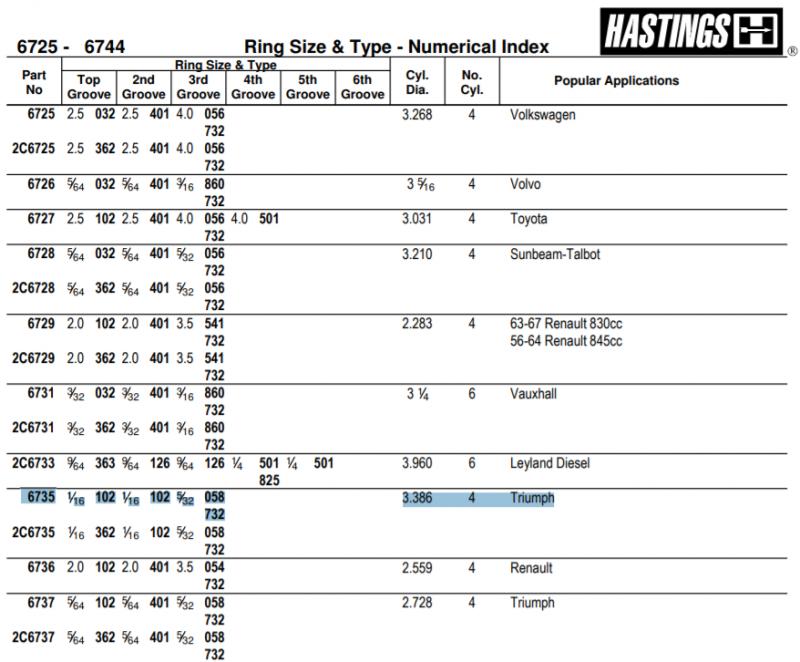

I found a table that shows SAE recommended gap limits for various cylinder diameters that ring manufacturers are supposed to adhere to. A 3.425" bore would have a limit of about 0.020". General rule of thumb seems to be a minimum of 0.0035" of gap per inch of cylinder diameter, and a maximum of 0.0055" of gap per inch of cylinder diameter. That would put the 86mm 040 Hastings rings (and the Grant rings) near the upper limit, which is spot on with John's previous comment about manufacturers ensuring the rings are supplied with no chance of them touching in service in the tightest bore. It is good to hear that a few others have built multiple engines with this type of gap and seen no negative effects, so I will proceed with the Hastings rings as-is.
I do have one more slight concern for which I would like some feedback. The Hastings ring box arrived with the perforated cardboard ring dividers torn, so the rings were mixed up (no damage). This is not a problem for the oil rings, but 1 & 2 appear to be identical. Upon inspection, I can see no discernible difference in dimension, shape, or color, but I'm not sure I would be able to tell if there was maybe some special process on one versus the other. The ring box is generic with a sticker applied to indicate what's inside, so I'm pretty sure it would have 1 & 2 slots even if they are the same. I also seem to remember the Grant 1 & 2 rings were identical (they look it). Can anyone confirm if 1 & 2 are the same? If there is good reason for me to be concerned, I will buy another set. I'm afraid if I send these back to Moss they will end up in another engine rebuilders shipment, so I'm not going to do that.

Thanks for link - both 1 & 2 are type 102 cast iron rings. Since I didn't see any difference in the color or coating, I will assume they are interchangeable. I guess I am ready to proceed with the rebuild! Thanks for all the advice!

Just wanted to close out this topic with information provided to me by Hastings on the 6735 040 (87mm) rings. Allowable gap is 0.012" to 0.022", and the 1 & 2 rings are identical, and therefore interchangeable.
