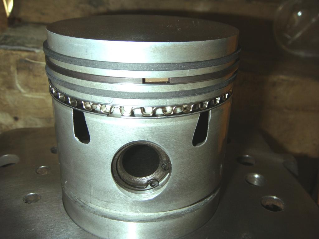

I would also recommend heat-shielding the piston crowns (helps to keep the oil cooler too) and the skirts with a dry-film lubricant. Treating the skirts also reduces drag, and virtually eliminates scuffing on cold starts__of particular benefit to cars that aren't driven daily.
Here's some Healey pistons that were done for a couple of board members:
