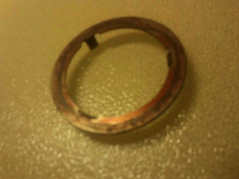

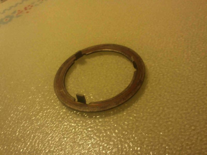

Don't know what this part is. Saw it laying on the work bench where I recently had my steering control box apart for the TR3. I went back to look at the rebuild link and didn't see it there. Any help here?

You might want to give a dimension or put something (e,g, a dime) in the photo to show scale. But no, I do not recognize it offhand.

It looks similar to an internal part of the trafficator, but I beleive the part I am thinking of is steel and your part looks brass

It looks like the horn contactor...when you say steering control box, I assume you mean the turn/horn control, or trafficator?
To make sure it was an "extra" part, you might want to put an ohm meter on the wires and operate the trafficator t make sure all the contacts are in there.

Yes it looks like part of a horn ring for a later TR.

I was thinking later TR, like on a TR4 through TR6, not for a trafficator box?

I actually have the unit together as of tonight and everything works. Took a look at the breakdown of parts on the repair website and it does not show that part. I thought maybe out of my TR250 horn center but they have longer tabs on them. Now I can't figure out where it even came from now and the only car I've been working on is the TR3.

That sure looks like the chromed surround ring that fits around the horn button. It even has the correct dimensions. It should be shiny chrome. It actually does not attach to the horn button itself but instead attaches with its three tabs to the adjacent steering piece next to the horn button. When attached it is a beauty piece that surrounds the horn button.

If the horn continuity checks good...then your trafficator has to be assembled with all the parts.
I have a box of parts that I have no idea what they are, but they look to important to throw away. Occasionally I even figure out many years later what they are.
The only other guess I would have for your part is there are some thrust washers in the tranny that are tabbed. Your's does not look substantial enough to be one, but it is similar.
