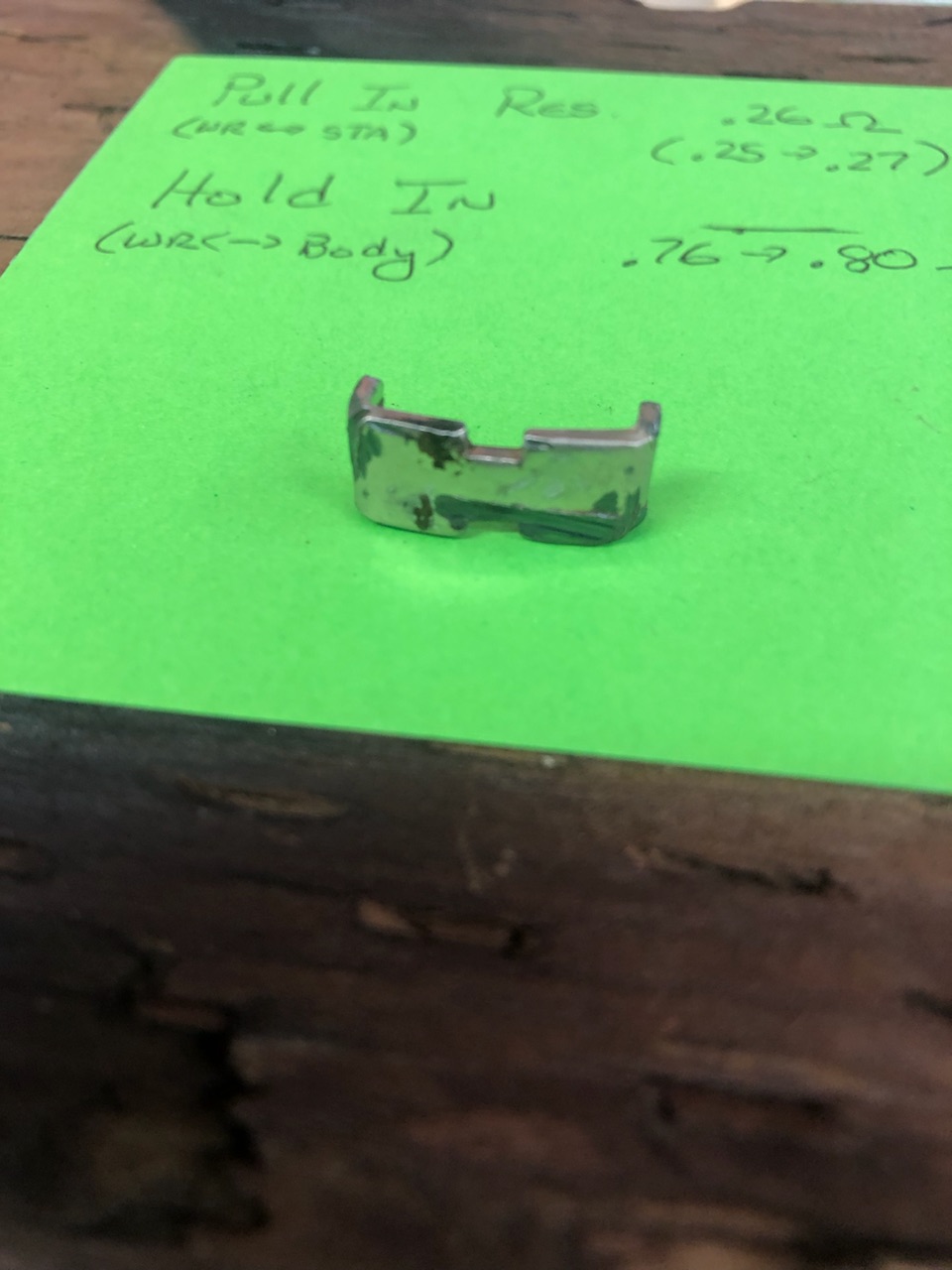

I’m refurbishing a 2M100 starter.
While disassembling it, I found this “spare part”. It looks like a contact, but doesn’t seem to be.
Doesn’t seem to fit as a “cap / retainer” on the top of the solenoid linkage to Bendix throw-in lever.
Suggestions?
Thanks -
From the wear marks, it looks like it was riding on the commutator…. I’m sure it’s not supposed to be there…. It doesn’t have the correct dimensions to fit in the cap holding the brushes…
R
Rocky_LC
Thanks, Ed…
Great find. I’m still waiting on new bushes, so I’ll use the article to ensure correct assembly.
Appreciate the link.
Rocky
PS. I just realized you did the write up for the starter rebuild and casting of the endcap. Very great work, and thank you very much for your posting.
It’s very helpful.
