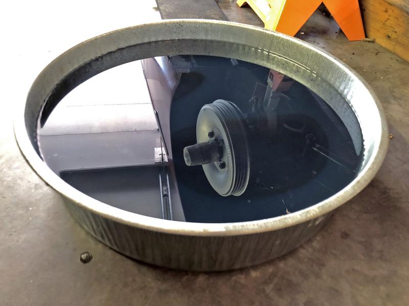

We drained TEN quarts of oil from the engine. The previous owner (PO) had reshaped the oil pan to eliminate the forward vertical edge, making it a slope so that, presumably, it would merely ride over anything it encountered, rather than getting torn off or badly damaged. Perhaps this was in response to a nasty incident? On the recommendation of a local engine shop, we added Joe Gibbs break-in oil (conventional oil, 10w-40) for our start attempt, and it took TEN quarts. Here's a pic of the old, drained oil, looking remarkably good actually - at one point we were beginning to worry that it would overflow the drip pan:

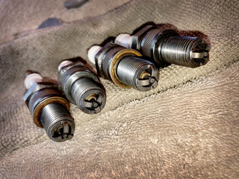

And then there are the spark plugs. These look very good (and we re-used them - more on that later), but I'd never seen this three-prong variety. Maybe they were the equivalent of the infamous Fish Carburetor in their day? A special high-performance option? Gapping them was interesting.

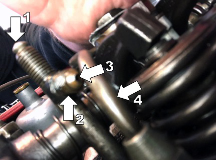

And lastly, for now, is the oddest one of all. One of the rocker cover studs is very creative. (Sorry about the focus, but perhaps you can still see what you need to see):
Arrow 1 points to a passage at the top of the stud. Arrow 2 points to a "branch" of the stud, welded on, that is threaded for some reason, and Arrow 3 points to an opening for a passage through that branch, and it connects to the passage from the top (arrow 1). Arrow 4 is the oil feed line for the rocker shaft. What possible purpose could there be for that passage from the top of the stud and down and out the side extension? Someone went to a lot of trouble to make this special stud, with no apparent reason for this passage. A plain stud would do nicely.
