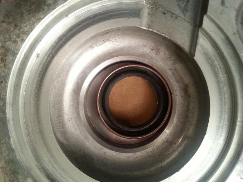

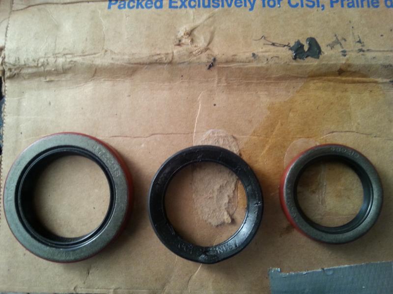

The transmissions out new clutch is on the way and I have new seals on my shelf. The question is would I be opening things unnecessarily? I know I should expect a small amount of "territorial marking." Will I regret not putting new seals in now?
80xxx miles on the 78 B.
