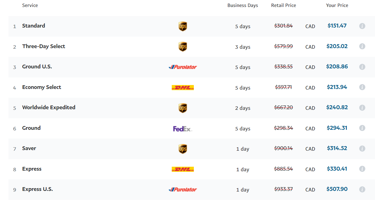

1. drive across the border and ship from Montana (or whatever is close) We live 1 1/2 hours from Buffalo and in non-covid times it is typically cheaper and quicker to just go that route.
2. I have had good success recently with a company called netparcel - did a quick look - 24" X 20" by 20" parcel by 100lbs (BUT only a $100 valuation!) and this is what they came back with

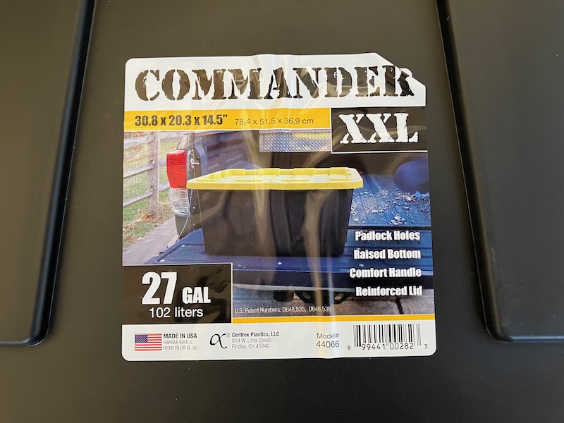

drooartz
Here's the tote I used to ship a Datsun trans in the past. Bought these at Lowes. Commander XXL 27 gal tote. 30.8x20.3x14.5".
