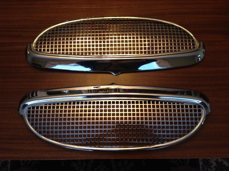

Rut

Mark,
Not Fred, but the 2 grills in the above picture were replated for me by Knox. 1 grill had a small flaw when it came back and they fixed it quickly...1 grill had been rechromed before and the other was pretty much a rusty piece of metal. I don't know the current cost, but I think it's fair for this day and time and the quality is excellent! I've got more items to be chromed and they will go to Knox.

Mark,
I had the same dent in the top of one of my grills and it was gone when I got it back. You can call them and email a picture and they can give you an accurate quote based on the condition of your grill.
