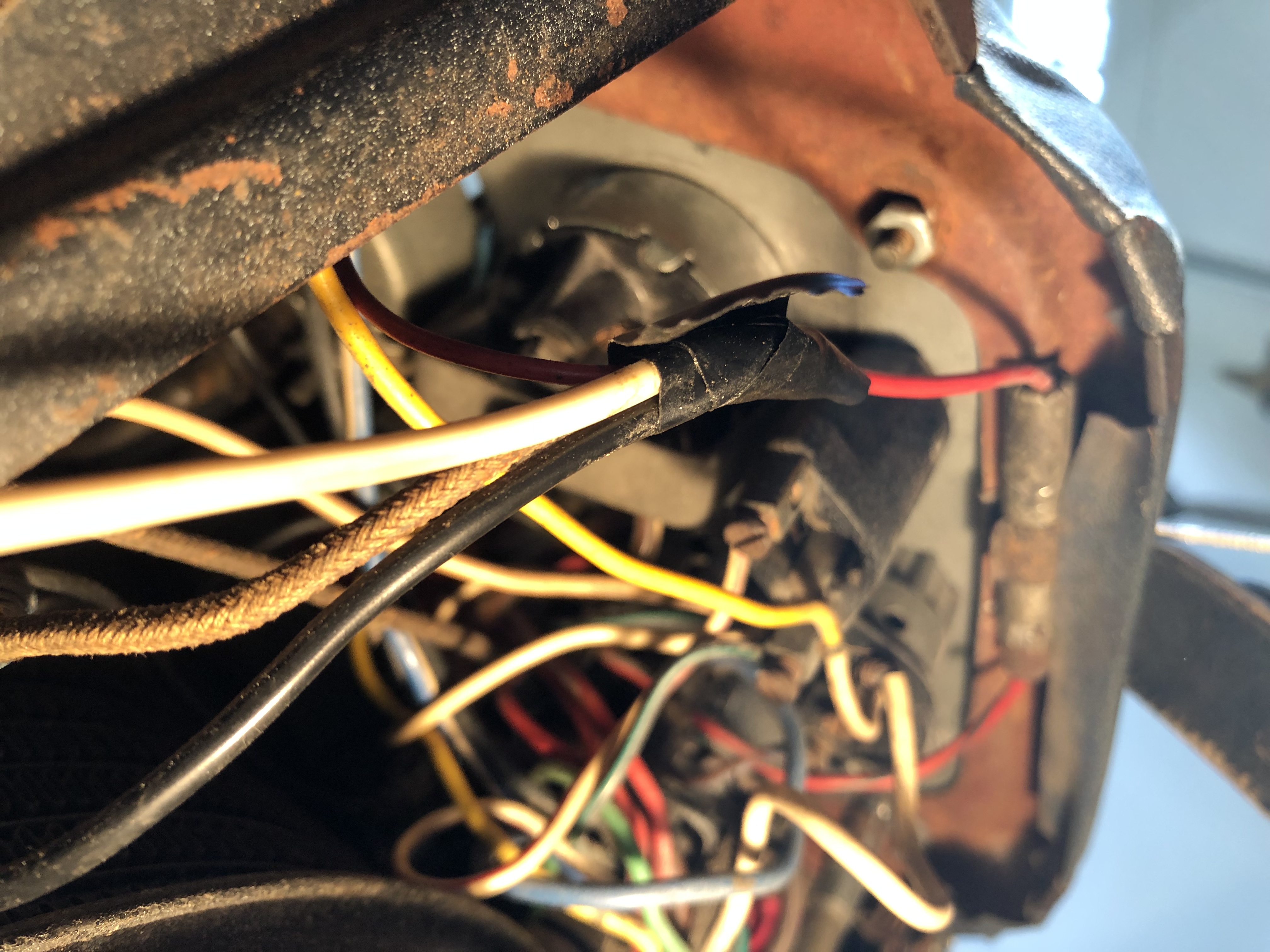

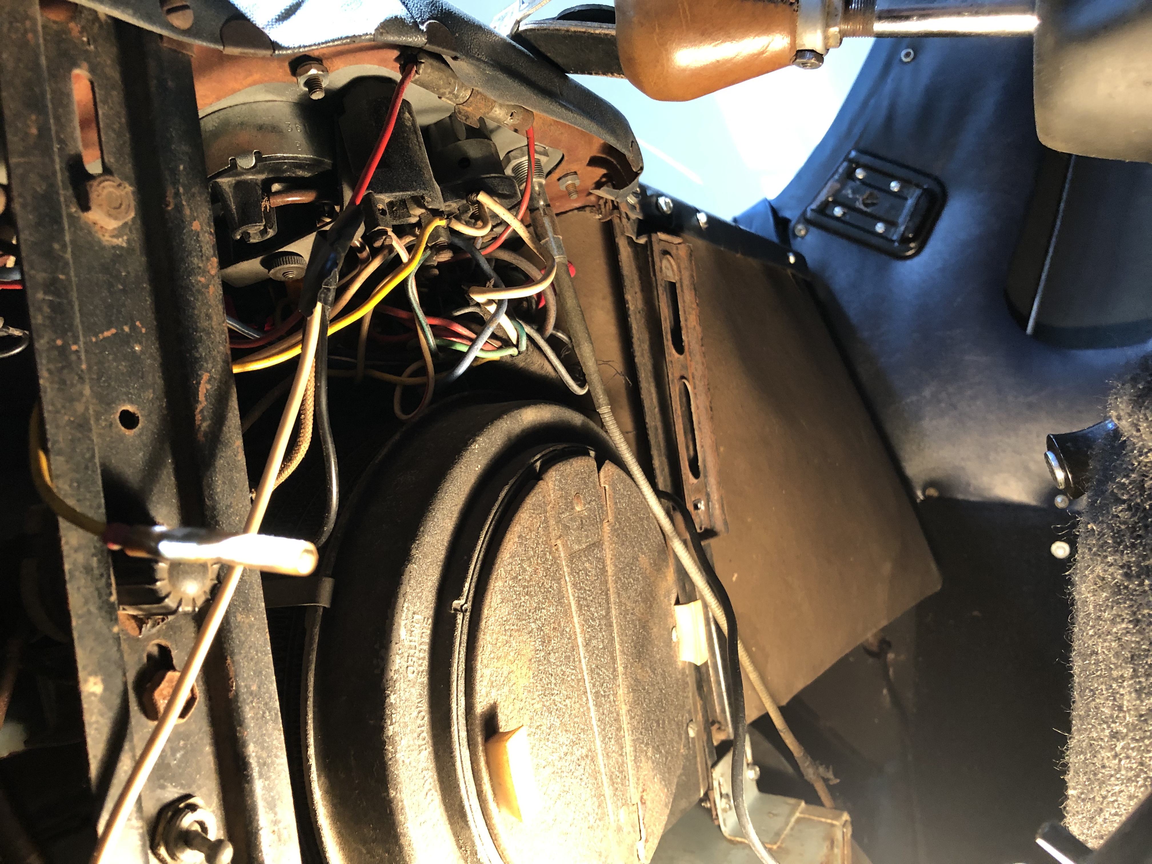

Hi, anybody out there. I’m planning to replace my TR3A temperature gauge, but the wiring on the back of the panel is very dirty as well as some apparently custom (I.e. different color) wiring, and gauges are in different locations.
To start with, what would you recommend to clean the back of the panel: see photos below.
DavidApp
Wiring on an old TR3A can be a can of worms.
Does everything work? If everything works and you are just replacing the temperature gauge you may be able to finagle it in there but if things do not work it may be time to do a refresh behind the dash. Label everything

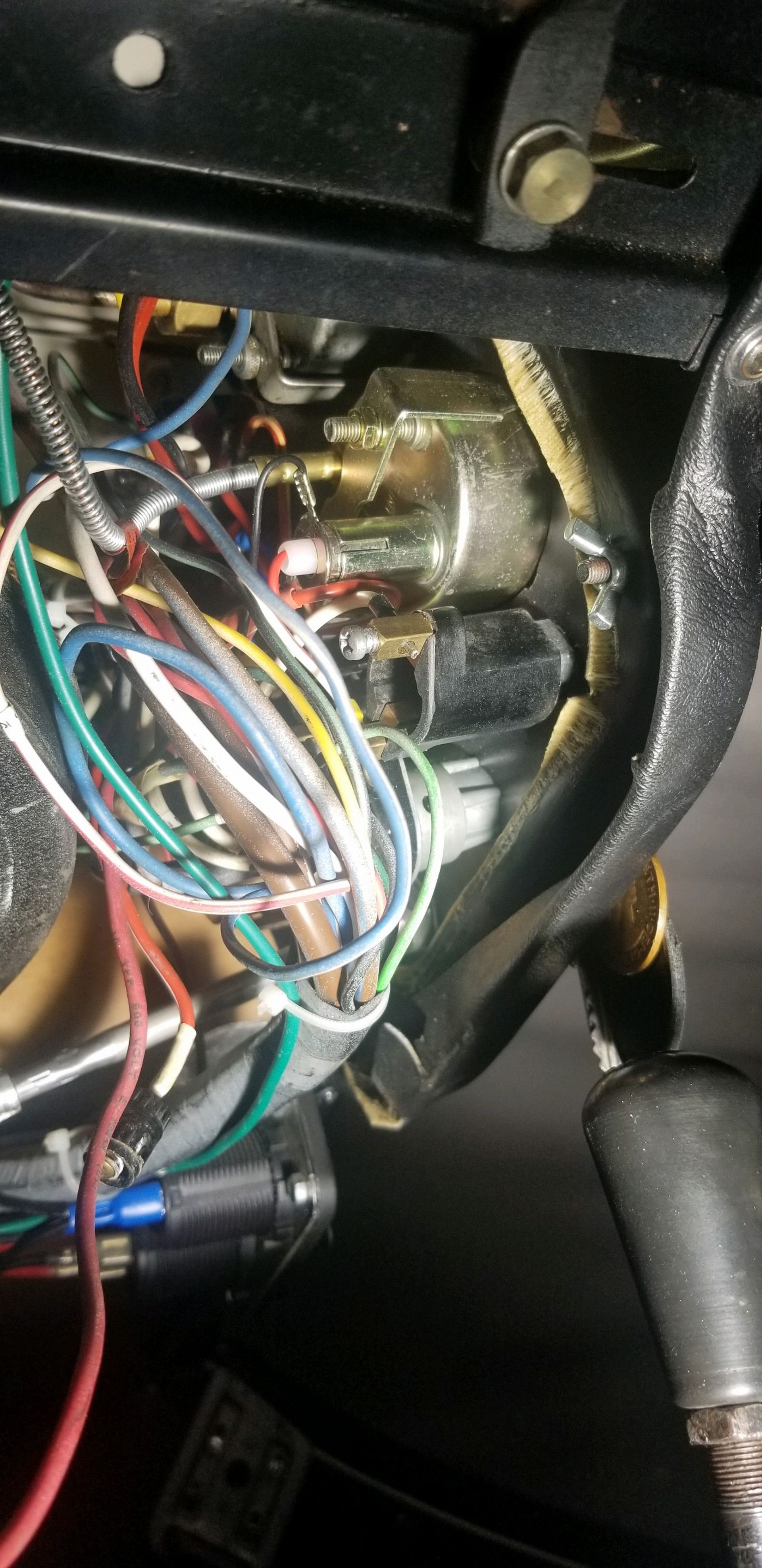

This is a photo of my recently completed TR3A restoration dash with a new wiring harness. I tried to keep everything neat but there is only so much room up there.
David
PS.
Glad you asked abut the dash because as I looked under there for the photo I found my side light connection at the fuse has broken.
