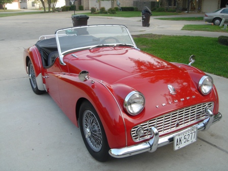

I have gradually come to the conclsuion that my TR3 is running a little rich. It is getting less than optimum gas mileage (somewhere in the high teens), the spark plugs have a black buildup, there is a bit of smoke (very little) evident from the engine compartment but does not seem to be coming from the exhaust pipe, and at low rpms (like when you switch up to the next gear) it misses a bit until it gets warmed up or I drive at higher RPM's to "blow out" the carbs.
Does it sound like I have concluded the right thing? Is it running a little rich? I am one step shy of totally ignorant when it comes to working on these things, but since I would like to avoid the cost and hassle of having a mechanic do everything, it seems like this would be something I could adjust myself. How do I make the necessary adjustments and how do I know I have done it right?
Thanks for your help.
