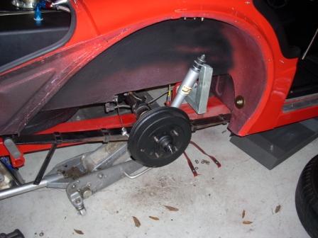

I seem to remember reading something about 15 years ago, but I can't remember where. It said that when doing an oil change, save the drain oil and paint it on the leaf springs to keep them quiet and free to move. Does anyone do this, or am I just dreaming?
