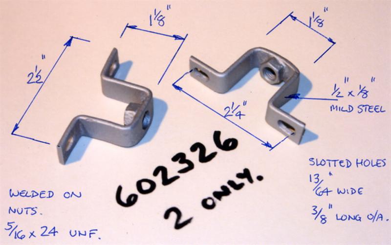

Hi Tom,
I know that the fixing kit is quite expensive. If you want to have a go at making the bridging pieces, it may save you some money. These pics were posted on another forum by "Les". Nice pics with dimensions. Looks like two different sized bridging pieces but I think the TRF Kit supplies all 5 bridge pieces the same size as the one in the right side of the photo.

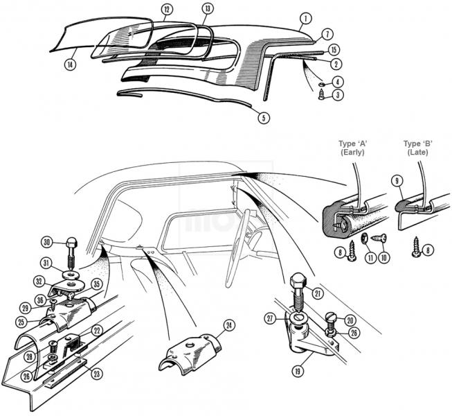

You can see all the other bits in this diagram...
