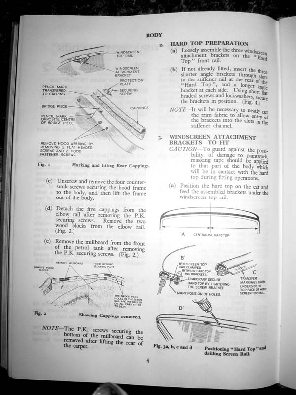

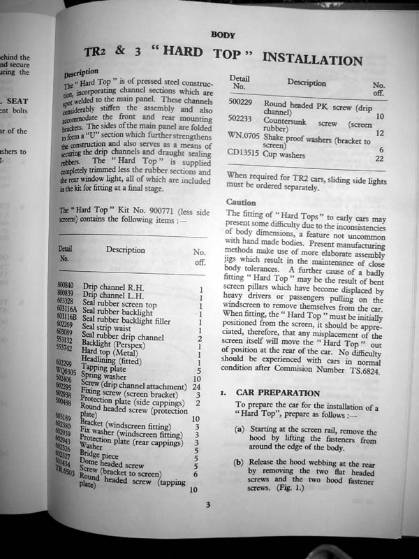

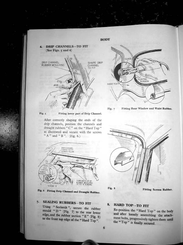

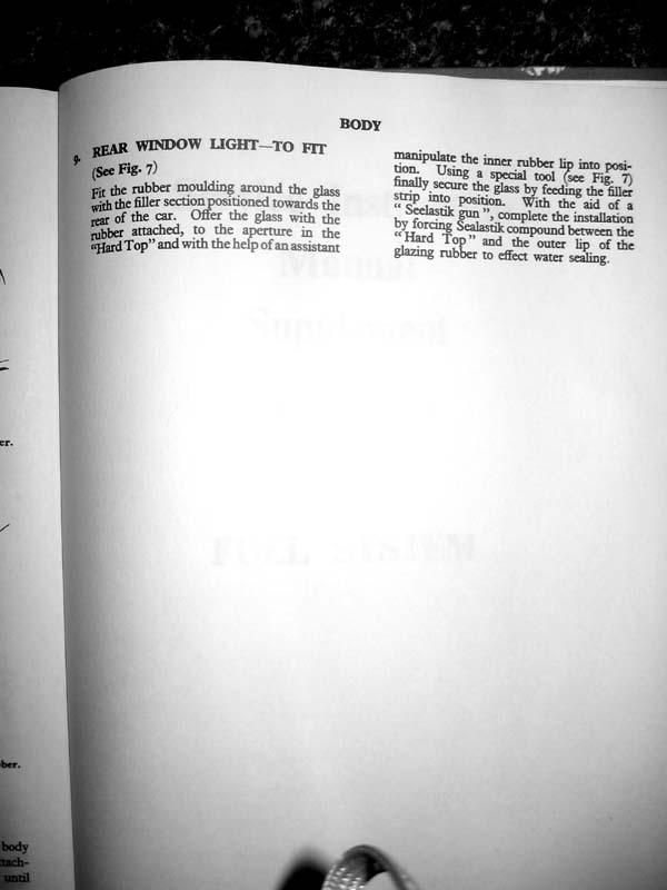

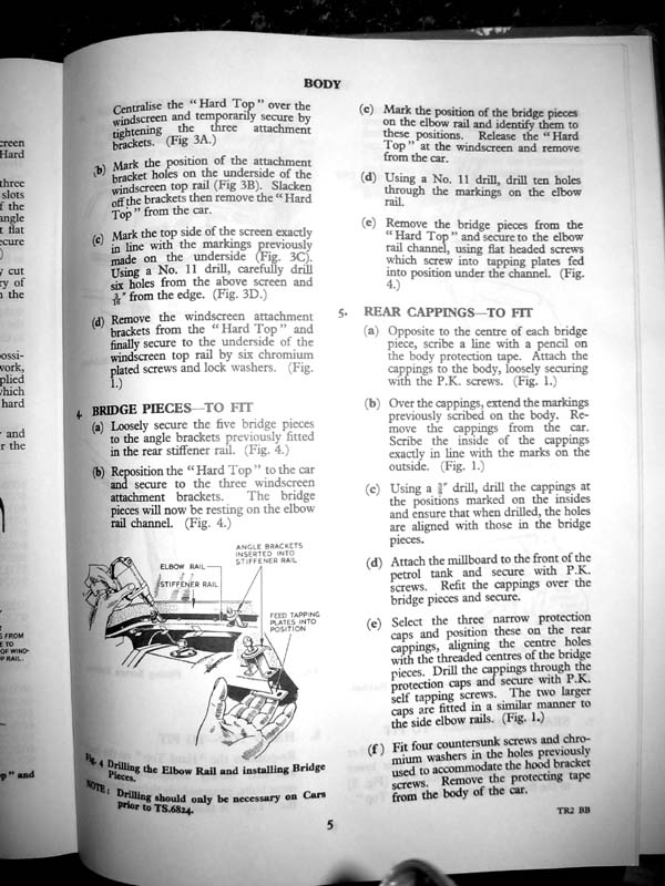

OK, apparently the scanner is only for making copies. At least that's what I get from reading the convoluted instruction manual. So, I decided to just photograph the pages. Hopefully they will be intelligible...
Edit: Doesn't look too bad. If you download the pics, you can always just magnify them if needed, especially the pictures. The text is very readable.
