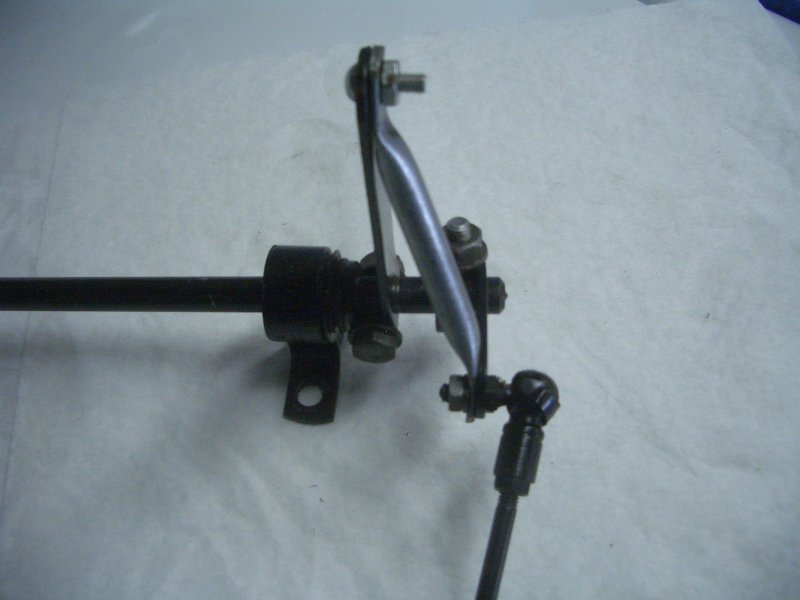

Beware of the bellcranks shifting after you install the engine. I like a brace between the arms:
Bob_Spidell
That's a good idea, but can't they still shift (albeit together)? To my surprise, my bellcranks were tack-welded--rather sloppily--probably to solve this problem. Anyone know if the factory did this, or was it a DPO?
According to the "Original Austin-Healey" by Anders Ditlev Clausager, the factory started welding them beginning with C.14378 in June of 1961.
My '61 German export tricarb project (C.14391) is also welded rather sloppily!

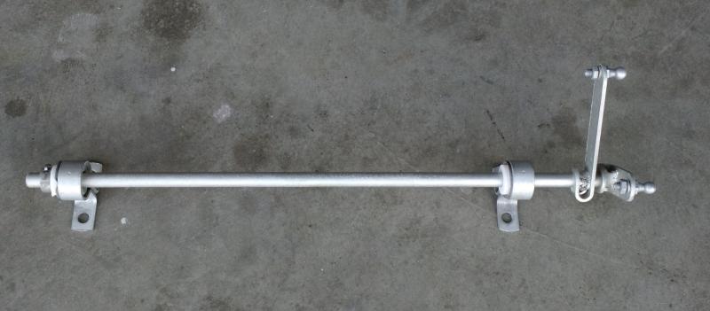

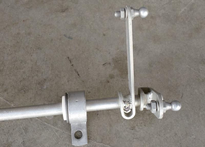

Cadmium Plated Throttle Linkage with Bushings

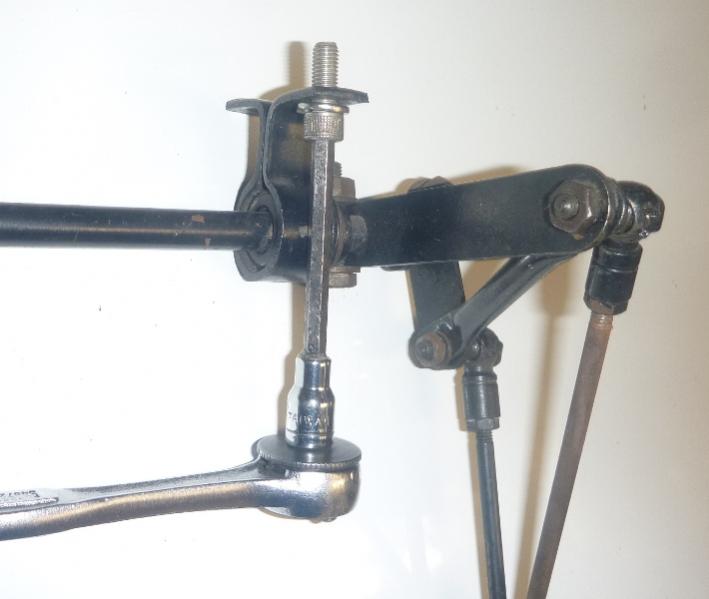

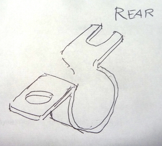

Mine haven't shifted in 10 years. I modified the brackets (slotted the rear holes) and mounted with allen screws.
Addendum: Turns out I didn't do the slot after all. Was not necessary with use of Allen screws ( 1/4-28 x 5/8" SS). FWIW the brace is 2.8" c to c.
Addendum 2: if they shifted it wouldn't matter because the brace keeps the bellcranks in the same position relative to each other.
