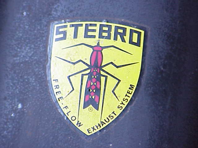

angelfj1
Long live the mosquito! Man, what a sound!!!
