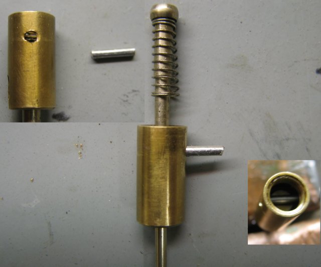

The rich condition turned out to be a broken tang on the brass body, DPO thing??? The left image shows where the tang was bent in above the needle to locate the needle in relation to the body. The spring pushes the needle up against the tang. When the tang broke the spring pushed the needle up against the adjustment screw in the air valve. Where ever you had the screw adjusted to the needle was always in the same location. To fix this I crossdrilled the body and fabricated a cross pin, center image. The right image shows the cross pin from the top. Thanks,
