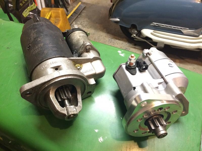

Just found this pic I took showing the size (and weight) difference between the OEM starter and the modern gear reduction starter.
Platinum
The weight difference was what impressed me.
The battery terminal on the new one is in a bit of a dangerous spot in an MGB, in that the lower clip securing the dizzy cap could drop down and make contact with it. I made up a new cable to run from the remote mounted solenoid to starter and used the rubber boot furnished with the new unit to hopefully preclude any such problem.
