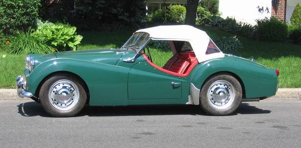

A TR owner in Toronto paid a shop over $4000,00 to improve the engine in his TR3A, The day after gettting it back, he was on the 401 when he got plowed sideways by a tractor trailer. The TR was pushed sideways like it was a snow-plow on the front bumper. The driver suffered only a broken leg and his ankle. The front bumper of the semi was pushing him on the driver's side. Then the car sat in his garden under a tarp for over three years - winter and summer - snow, rain, humidity, etc.
I restored the car over the next 7 years finishing in 2006 but he told me he didn't want anything done to the engine. Compression read very, very, low. But when it came time to start it, it ran fine. After it wearmed up, the compression was 155 psi on all cylinders. The photo shows the final result after a new frame and a total body-off restoration.
