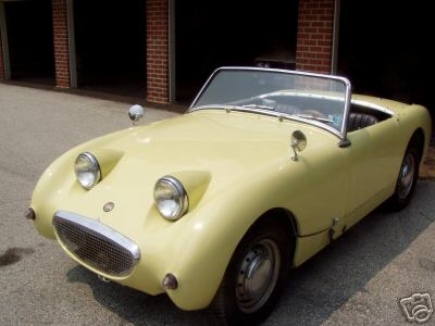

smaceng
Is this what you are looking for?

mightymidget
Yes, wanting an orginal Bugeye color if possible. only have photos to go by. Is that a AHBE color?
I am going with chrome wire wheels and red line tires so the yellow needs to be very soft, buttery
Also "IF" I can find the correct blues I am going to to cover the seat bolsters in stone washed denim with small blue/yellow plad in seat inserts and white piping. The inside of doors will be same plad with denim on door pockets. (If I can get these colors right I may even go with Blue line tires)
Second choice is a tone of Red for interior. I know I am working with some tough colors but I can see them in my head. and of course third choice the standard black, not fond of saddles.
Dash will be a nice wood inlay. Remember this is a car I am fixing up for my wife so I want it "snazzzy"
