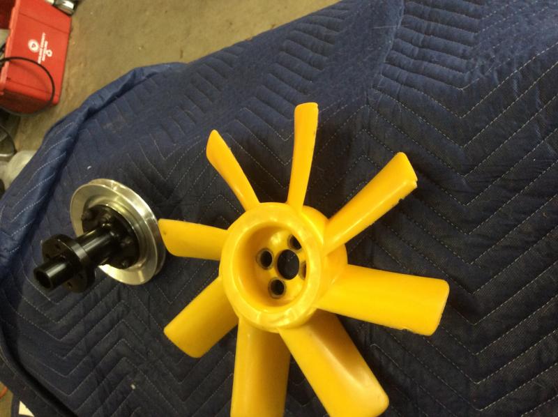

On the issue of dampening and the fan's rubber bushings, any thoughts about changes in dampening if poly bushings are used? I got one of the BPNW narrow belt kits last year and it will go onto my in progress car, along with a Macy fan. - Walter

A harmonic balancer reduces stress on the crank bearings. Wikipedia has an article on it: https://en.wikipedia.org/wiki/Harmonic_balancer
When I was improving my wife's Sunbeam Alpine I initially attached a custom-made crank pulley that had no balancing improvements, and it performed poorly with excessive vibration. I replaced it with a custom-made pulley that had harmonic vibration minimization qualities and the engine is much smoother. The TR4 I have worked on since 1963 hasn't had a harmonic balancer until last year. As expected it's smoother and I expect the main bearings to last longer.l
