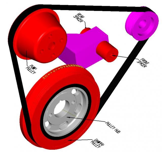

I had designed a serpentine pulley system for a TR6. I paid for the rights to use the SAE specs for the pulley grooves. The damper was designed to match the original damper's dynamics for centrifugal conditions and kinetics. The hub and other pulleys are aluminum. And the belt to be used was decided on after consulting with Gates and other companies engineers. This is a CAD/CAM/ENG solid model of it.
I am sure something similar could be done for the TR3/TR4 engines if there was an original available. However, it would need to be destroyed.

Were you able to measure the difference in actual power loss?
tomshobby
Randall, I never did make it. Bought a Midget in pieces and got involved in a complete restoration that got a little complicated. https://smithtr6.com/bearings.htm Finally getting back to the TR6 and starting in the rear of the car. Probably be a year or so before moving to the pulleys. The reason I did this project was to be able to use a belt that was easier to fit through between the damper and cross frame. There would be some power benefit due to the efficiency of the serp belt in place of the v-belt and a weight reduction in the damper's hub pulley and the w-p and alt pulleys. I actually have a machine shop that has the material and will make them for the return of a favor for some cnc programming I did for them so it is just a matter of time now. Not an immediate priorty though. It was surprising the amount of research that went into it.

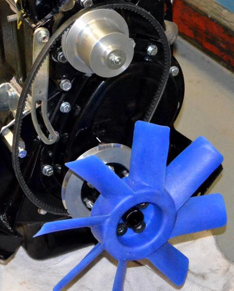

croz
Hello Randal,
Yes, the pulley (Revington TR) was designed for using a shortened extension (Moss 837-525). I use a blue TR6 fan - no red or yellow was available.
I feel that the parasitic power loss is minimal using this system and that adding the electric fan is needlessly complicated, in my case. I do see the advantage in hotter climates.
I see that Moss carries a dampened pulley, but it's not drilled for the fan extension.
