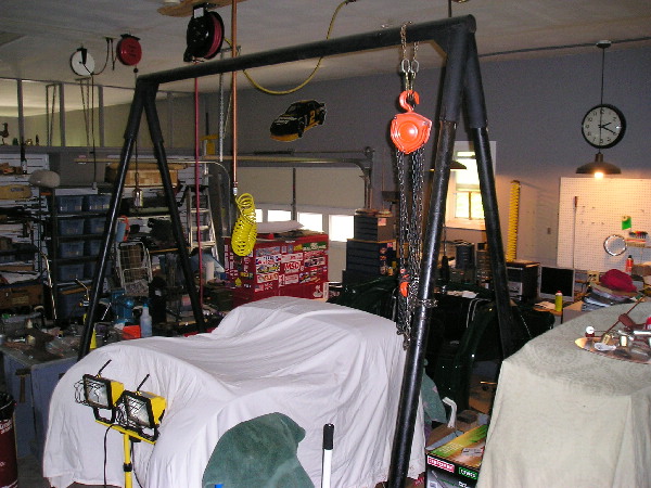

Afternoon all. Thursday May 28th will be a momentous moment in the restoration of my TR. I plan on taking the body off the roll around frame that it has been on since about 2001 and setting it on the TR frame, permanently! YEA! I plan on using the roll around A-Frame seen in the picture and using the chain fall to lift it off and rolling it to the frame and setting it on the frame and bolting it in. I will use a landscape timber, attach rope to the front and back end of the timber and use the chain fall hooked in the middle of the timber to hoist it up and roll it over the frame. My question is, what would be good front and back attachement points to use. Or should I just loop the rope around the body at both ends and lift it that way.
Your thoughts greatly appreciated!
By the way do you like my rat rod rally lights? heh.....
Thanks, Tinkerman

Man, that's an awfully heavy duty looking a-frame to lift a sheet!!!
How big of a frame are you going to need to lift the body of the car??!!! LOL

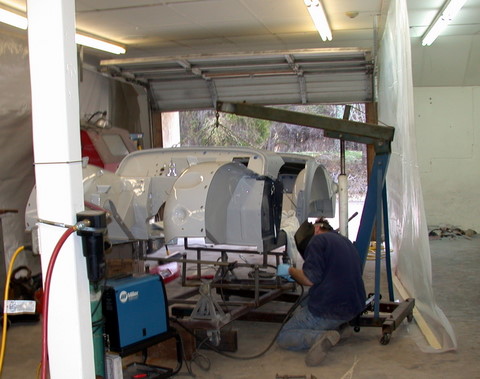

Dick: This is what we have been using. these shop cranes are quite adequate as the body shells are no so heavy. remember to watch your back!
Good luck

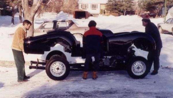

Dick - My son, my neighbour, a TR friend and I lifted the body onto the frame very easily. No problem. We did it on New Years Eve 1989.
