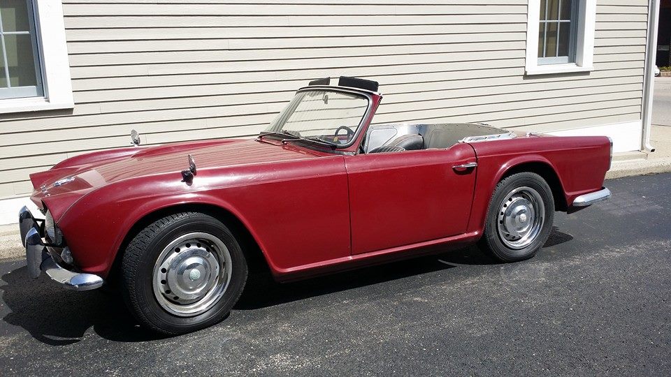

My father and I pulled this 1965 TR4 out of a car port. It was in solid shape but after getting it home I noticed it had been hacked by the previous owners over the years. My goal with this car is to turn it into a nice driver. After fixing a hole in the steel dash and going through all the wiring and getting everything working it seemed to run pretty good with zero attention to the engine systems. I drove it around for 2 months like this. It did have an occasional miss under load and high rpms but when I got off the gas it stopped. I guessed it might be the debris in the glass filter running the bowls out of fuel or the points. Then one hot day it went to crap quick. Misfire, no fire then dead. Before this I had sanded and adjusted the points with no change, still occasional miss under load and high rpms.
So now I'm going to go through each system one thing at a time. Carbs, lines, pump, filter, tank. Then ignition system replacing the points, condenser, coil and setting timing. I'm guessing all of this needed to be done since I have no idea how long this car sat before the two or three years it sat my shop. Hopefully I will have eliminated the problem. The car runs amazing other than this miss.
The car

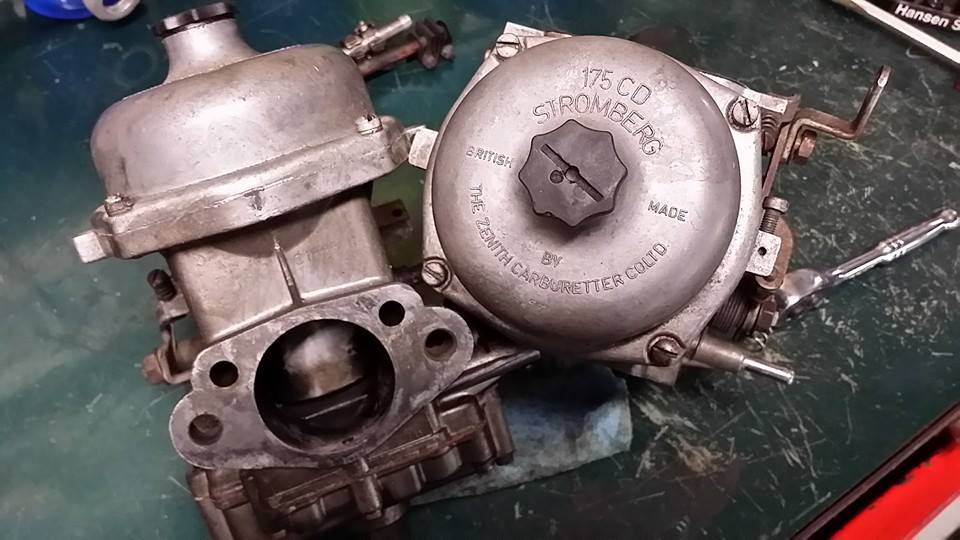

I've been doing a ton of research on rebuilding the carbs. The 175CD Strombergs are pretty simple. I just need to know the super secret pitfalls and things beyond the basic gasket rebuild that could give me tuning problems down the road. I've already disassembled one and was surprised how tight, clean and simple it is. I'll be getting rebuilds from Joe Curto or the like. Any suggestions of where to get the carb kits, points, condenser, coil and fuel pump or fuel pump rebuilds and fuel filter rebuilds. I'll be posting my progress and questions here as I progress through each task. Subscribe and participate! Thanks guys!
poolboy
Call Joe and offer to send him a picture because there are different versions of the 175 CD carbs.
Tell him you want EVERYTNING needed to rebuild those particular carbs.. Then just do a good job putting the carbs, cleaned and polished, back together; then set the adjustments as best you can.
Set the timing with the new components and then go try it out.
trrdster2000
Jeep, on the CD175 you have it is really a good one. Your biggest problem will be the centering of the jets, so the needle does not touch on any side. You will have to loosen and tighten the jet adjustment a bunch. The first setting for both should be even with the venture bushing, then screwed down 1 and one half turns. That should be in the neighborhood, then you can start lifting the piston a 1/8 inch or so. If reeves up, go up a quarter turn and try again. If nothing happens you are real close and only driving and checking the plugs will you know if it's a little lean or rich.

The carb rebuild is pretty easy, everything should just go back together the same way it came apart, make sure you get the throttle plates properly centered so that they can be closed all the way without sticking, otherwise it will be hard to adjust your idle, make sure you don't tear the diaphragm, the big rubber bit, when you put the tips back on the carb. Check to make sure the throttle shafts aren't worn with excessive play. Google these: Full line parts suppliers are The Roadster Factory, Moss, and Victoria British, Roadster factory often gives you more description of whether the part is the OEM spec or just fits and works. British Parts Northwest has mechanical bits at good prices, Burlen Fuel Systems has carb bits from England, but you can get most of what you need here.

I recommend Joe Curto too - especially on calling him. I rebuilt the same set of carbs you have for my TR4 using Joe's rebuild kits and they've been running great for 2 years now.
Joe can rebush the carb bodies and install the butterfly valves - best thing I did as this is the wear point on the carbs and you won't get a good idle otherwise. TR4s have very simple carbs you'll have no trouble rebuilding them.
Edit: forgot to add you don't need to rebush unless you see some play in the throttle shafts - Joe's rebush service doesn't cost near as much as having him do a full rebuild and he can turn around the work quickly - worked that way for me anyway.
