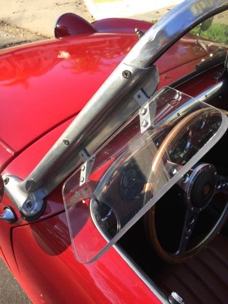

gonna try making some wind wings.
matmire
gonna try making some wind wings.[FINISHED]
A forum member is already mailing me a template for cutting the Lexan, but I plan to make the hardware as well. Would anybody mind taking a nice straight-on photo of their hardware up against a ruler so that I can get my scale in the ballpark? If you can do front and side views, that'd be even better!
Also, I was planning on using 3/16" or 1/4" Lexan, but does anybody know how thick the original AMCO wings were?
thanks!

Finished! It was a lot more work than I expected, but that seems to be the theme of most of my Bugeye projects. I made a photo album of the process... HERE

Matmire,
Excellent work on those wind wings! I had 2 different sets, one was purchased from an eBay supplier who didn't come close to your level of quality and the second was a period Amco set that came on a TR4a. Yours look as good as the Amcos and that's saying something! One suggestion...when you countersink the holes in the Lexan for mounting it creates a weak spot that eventually cracks...you can use screws that mount flat to the Lexan which should solve that issue.
Rut
Interesting, I guess if/when these crack I can make another set without counter-sunk screw holes. Thanks for your kind words!
