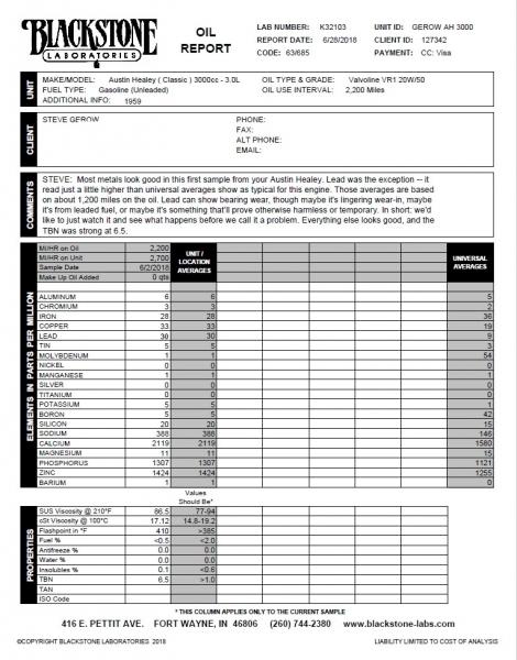

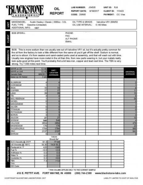

Comparing two Blackstone reports on newly rebuilt engines:
This oil was my first oil change 2300 miles after changing out my break-in oil. Will get another report done after next oil change.
Bob S - Helpful to be able to compare with yours as we got our engines done at approximately the same time, though you have a lot more miles by now.
Once I can figure out how to open the pdf and edit it, I'll post my most recent Blackstone analysis report up, showing a trend from the last five (5) oil changes. It's only a couple-few weeks old__the report, not the rebuild.
