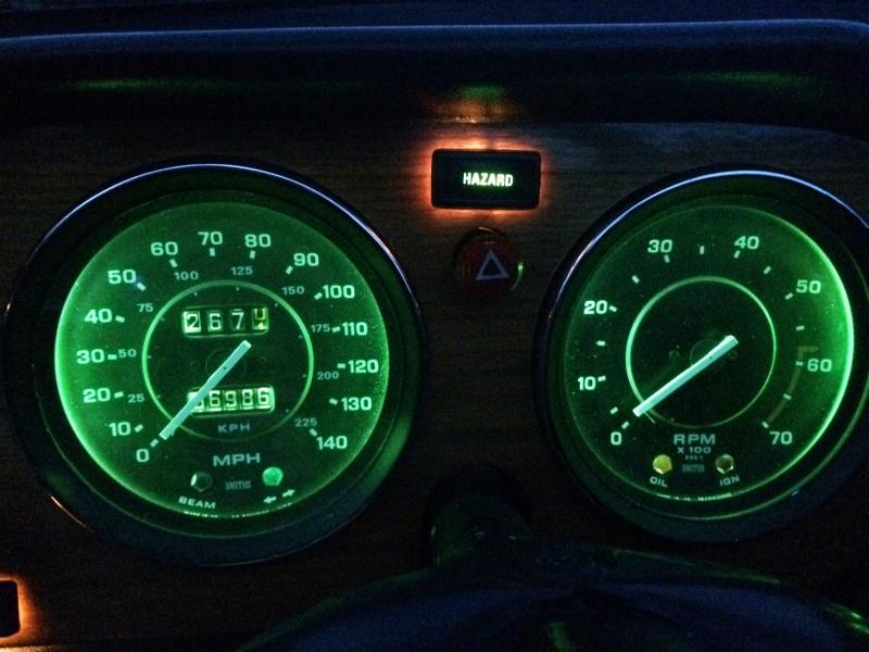

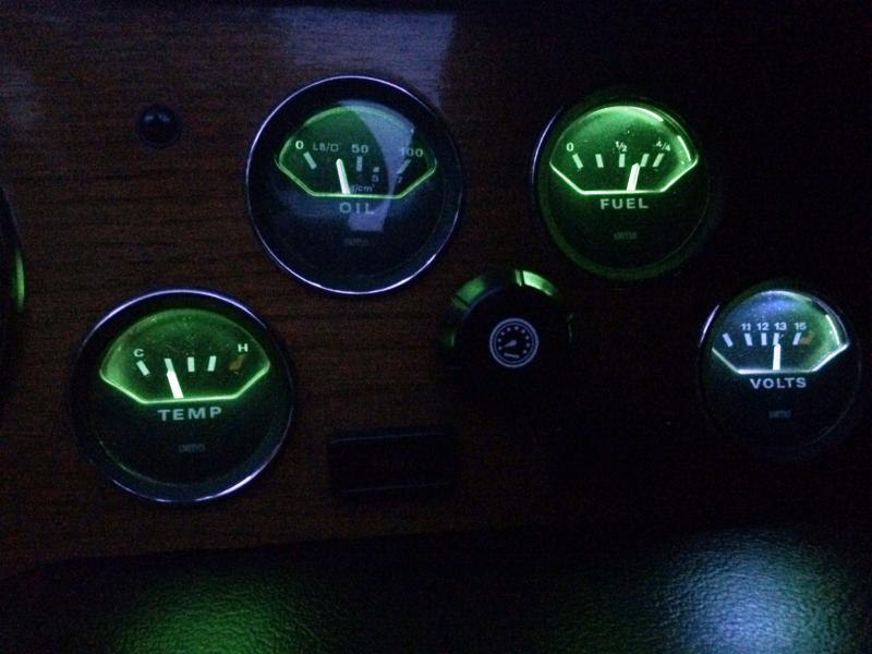

A couple of weeks ago I installed LED's into all the gauges of my TR6. Tonight I took the car out when it was dark and oh my, I can now actually see my gauges!
I'll bet if I bypass the rheostat they will even be brighter. Have a look.....

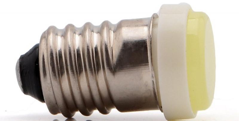

You are welcome guys. Some of the receptacles are a pain to get to. Thanks to poolboy's suggestion I was able to get to the small gauges by removing the ashtray on top of the dash... but it was still a pain to get to them.

I have no idea what bulbs are in the TR4 gauges. It would be easy enough to remove one and check to see what kind of base it is and then do a search for an LED if it's different than an E10 base.
Also remember that polarity matters on LED's.

Perry, if your current bulbs work then I can only assume that the ground is good so the LED's should work. Make sure they are screwed all the way into the base so they make contact with the positive side.

I bought LED lights from Moss and replaced the dash lights in my 1964 TR4...really made an improvement...you have to get the short base bulbs though...Marla

Couple of answers for above: yes, colored lites are available (especially red for our tail lights) and positive ground are also available. I think I got mine from Litezupp Industries — just google them.

I replaced the dash lights with litezupp LEDs for both Spitfires. What a difference! Also added red LEDs for the brake lights and amber for the turn signals. The clear / white? LEDs for the running lights seems as bright as the headlights. When I apply the brakes at night, it so bright it almost singes the eyebrows of the guy behind me. Communication with Litezupp seems to be limited to email and website, but they were quite helpful with returns when I ordered the wrong lights for the dash.
