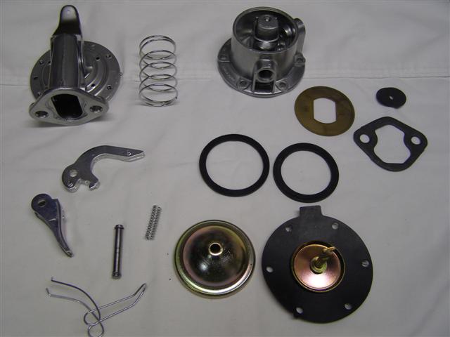

If you rebuilt it, then you replaced the diaphragm, right?
If you did, you had to push the rod down through the seal in the bottom pump housing that keeps oil out of the pump, and fuel out of the engine, if the diaphragm leaks. It sounds like you have a pinhole in the diaphragm and it's leaking by the seal.

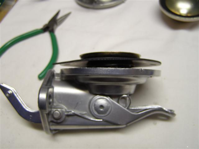

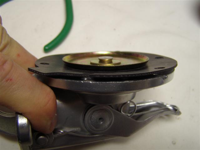

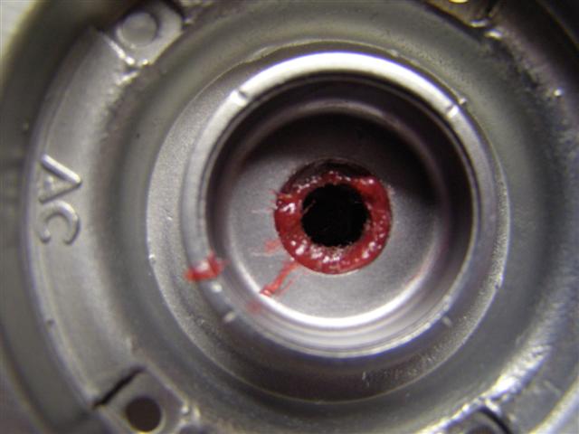

EDIT : Added pictures

A dumb question, but, are the six (6) screws holding the cover and body together tight?

Interesting... yes, the screws are tight... checked those.
I wonder if it is leaking through that hole on the diaphragm. I recall the shaft that goes through there had a sharp edge, maybe it tore the seal? It seems like that'd leak gas into the engine, but not out of the housing? Is that right?
Oh, hadn't thought about the engine oil thing.. I'll check that!
Brosky
The only way for gas to leak from that hole either outside or into the engine, is if the diaphragm is leaking internally.
You might want to remove the pump and pull it apart again.
